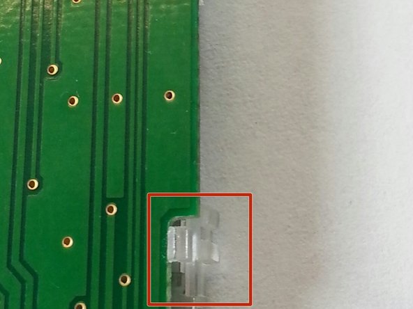

  5. Mitsubishi T200 Screen Replacement: crwdns2935265:05crwdnd2935265:01crwdnd2935265:02crwdne2935265:0 Mitsubishi T200 Screen Replacement: crwdns2935265:05crwdnd2935265:02crwdnd2935265:02crwdne2935265:0

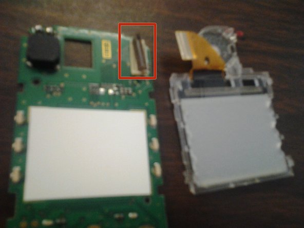

    • Unclip the four clips to remove the screen (connected to the clear plastic) from the circuit board.

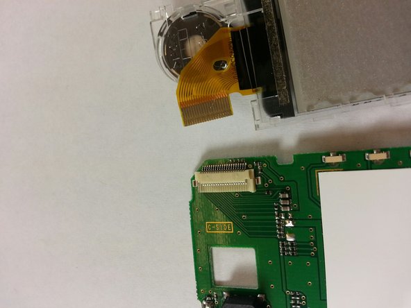

  6. Mitsubishi T200 Screen Replacement: crwdns2935265:06crwdnd2935265:01crwdnd2935265:02crwdne2935265:0 Mitsubishi T200 Screen Replacement: crwdns2935265:06crwdnd2935265:02crwdnd2935265:02crwdne2935265:0
    • Remove the attached ribbon from the circuit board by prying open the gray plastic clip at the top right of the circuit board.
  7. Mitsubishi T200 Screen Replacement: crwdns2935265:07crwdnd2935265:01crwdnd2935265:02crwdne2935265:0 Mitsubishi T200 Screen Replacement: crwdns2935265:07crwdnd2935265:02crwdnd2935265:02crwdne2935265:0
    • We can now insert the new screen and reassemble the device.
    • Place the ribbon of the new screen into the clip on the top right of the circuit board.
