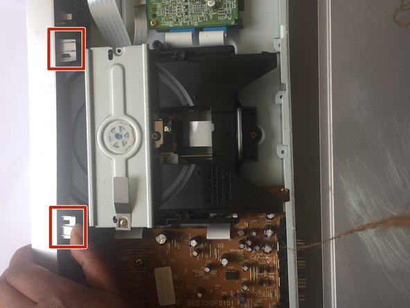

    • Unplug your DVD player prior to working on the device.
    • Remove five 1.2 mm Phillips #1 screws to disassemble the DVD player.
  2. Mitsubishi Electric DD-6040 Power Button Replacement: crwdns2935265:02crwdnd2935265:01crwdnd2935265:03crwdne2935265:0 Mitsubishi Electric DD-6040 Power Button Replacement: crwdns2935265:02crwdnd2935265:02crwdnd2935265:03crwdne2935265:0 Mitsubishi Electric DD-6040 Power Button Replacement: crwdns2935265:02crwdnd2935265:03crwdnd2935265:03crwdne2935265:0
    • Once the screws are removed, slide back and remove the cover.
  3. Mitsubishi Electric DD-6040 Power Button Replacement: crwdns2935265:03crwdnd2935265:01crwdnd2935265:03crwdne2935265:0 Mitsubishi Electric DD-6040 Power Button Replacement: crwdns2935265:03crwdnd2935265:02crwdnd2935265:03crwdne2935265:0 Mitsubishi Electric DD-6040 Power Button Replacement: crwdns2935265:03crwdnd2935265:03crwdnd2935265:03crwdne2935265:0

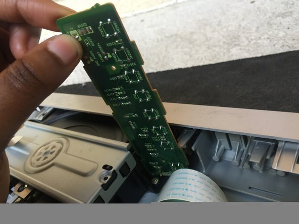

    • Gently pull out the green circuit board.
    • Be very careful, as circuit boards can be quite fragile.

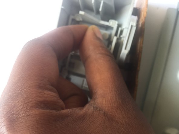

  4. Mitsubishi Electric DD-6040 Power Button Replacement: crwdns2935265:04crwdnd2935265:01crwdnd2935265:02crwdne2935265:0 Mitsubishi Electric DD-6040 Power Button Replacement: crwdns2935265:04crwdnd2935265:02crwdnd2935265:02crwdne2935265:0

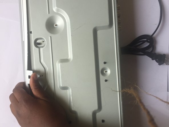

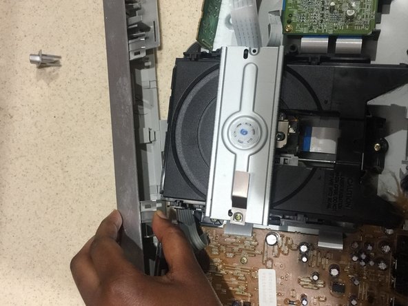

    • Flip the DVD player over and pull up on the clip.
  5. Mitsubishi Electric DD-6040 Power Button Replacement: crwdns2935265:05crwdnd2935265:01crwdnd2935265:03crwdne2935265:0 Mitsubishi Electric DD-6040 Power Button Replacement: crwdns2935265:05crwdnd2935265:02crwdnd2935265:03crwdne2935265:0 Mitsubishi Electric DD-6040 Power Button Replacement: crwdns2935265:05crwdnd2935265:03crwdnd2935265:03crwdne2935265:0
    • Once the clip is unlatched disconnect the corner tabs.

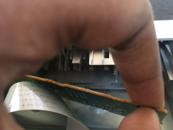

    • Reorient and unlatch the tabs inside the device.
    • Remove the faceplate.

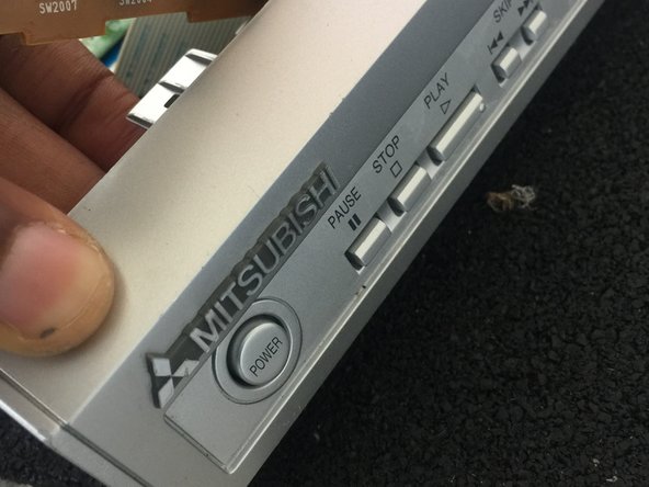

  6. Mitsubishi Electric DD-6040 Power Button Replacement: crwdns2935265:06crwdnd2935265:01crwdnd2935265:03crwdne2935265:0 Mitsubishi Electric DD-6040 Power Button Replacement: crwdns2935265:06crwdnd2935265:02crwdnd2935265:03crwdne2935265:0 Mitsubishi Electric DD-6040 Power Button Replacement: crwdns2935265:06crwdnd2935265:03crwdnd2935265:03crwdne2935265:0

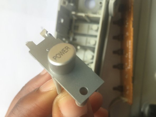

    • Pull on the old power button to remove it.
  7. Mitsubishi Electric DD-6040 Power Button Replacement: crwdns2935265:07crwdnd2935265:01crwdnd2935265:02crwdne2935265:0 Mitsubishi Electric DD-6040 Power Button Replacement: crwdns2935265:07crwdnd2935265:02crwdnd2935265:02crwdne2935265:0
    • Adjust and push the new button into place.
To reassemble your device, follow these steps in reverse order.
