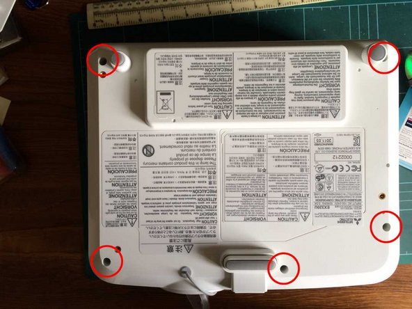

    3. Mitsubishi EX320U Projector Disassembly, Top cover removal: crwdns2935265:03crwdnd2935265:01crwdnd2935265:03crwdne2935265:0 Mitsubishi EX320U Projector Disassembly, Top cover removal: crwdns2935265:03crwdnd2935265:02crwdnd2935265:03crwdne2935265:0 Mitsubishi EX320U Projector Disassembly, Top cover removal: crwdns2935265:03crwdnd2935265:03crwdnd2935265:03crwdne2935265:0
      • Remove one screw from under the lamp cover.
      • Turn the projector over and remove 5 screws from the bottom. These are quite deeply recessed and you will need a screwdriver at least 6cm long.
      • Turn the projector the right way up again and work around the top cover with a spudger to release it from its clips. Lift the top cover off.

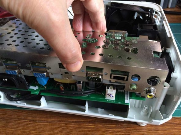

    5. Mitsubishi EX320U Projector Disassembly, Metal shield removal - 2: crwdns2935265:05crwdnd2935265:01crwdnd2935265:02crwdne2935265:0 Mitsubishi EX320U Projector Disassembly, Metal shield removal - 2: crwdns2935265:05crwdnd2935265:02crwdnd2935265:02crwdne2935265:0
      • Remove 3 screws from the back of the projector.
      • Remove 8 binding posts from the D-type connectors, using a 5mm socket.
      • The plastic back panel can now be lifted out.
      • Replacing the back panel can be a little tricky. Practice it now!
      • Lift off the metal shield, gently releasing the clips on the sides and the front, and easing it over the sockets at the back.
      • This metal cover is flimsy and easily bent. Try not to bend it, but if you do (which is likely), be sure to bend it back.

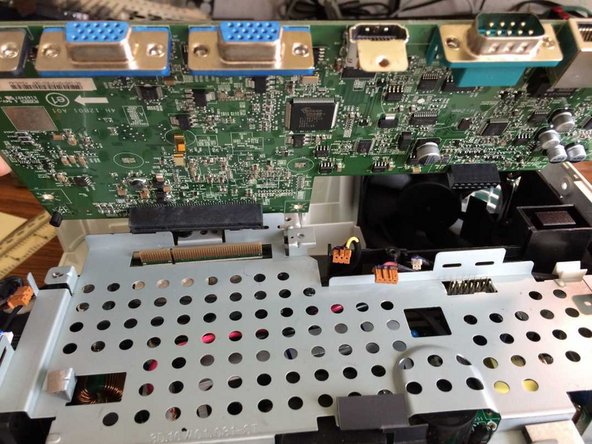

    6. Mitsubishi EX320U Projector Disassembly, Logic board removal: crwdns2935265:06crwdnd2935265:01crwdnd2935265:02crwdne2935265:0 Mitsubishi EX320U Projector Disassembly, Logic board removal: crwdns2935265:06crwdnd2935265:02crwdnd2935265:02crwdne2935265:0
      • Gently pull the ribbon cable by the optical assembly out of its socket.
      • Disconnect 7 other cables.
      • DO NOT disconnect the cables by pulling on the wires, but rather ease the plugs out of their sockets. They will come out quite easily if you grip them with a good quality pair of tweezers or repeatedly pull on one side then the other.
      • You can now lift off and put aside the main logic board by easing it upwards from the front. When you get it off you will see that it was retained by 2 connectors: an edge connector on the optical assembly and a pin block to the right connecting it to the power supply board below.
      • On reassembly, make sure the two connectors on the underside of the logic board are properly engaged and pushed fully home.

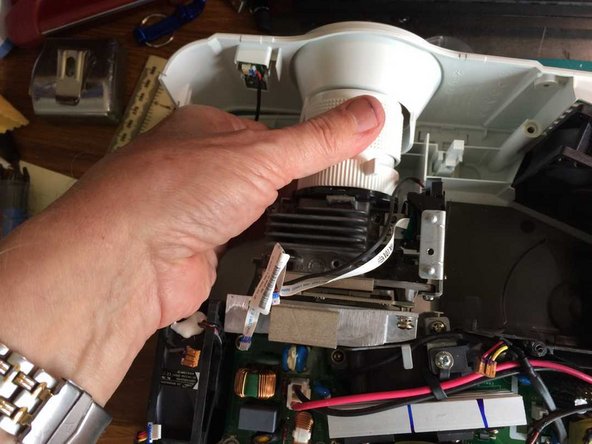

    8. Mitsubishi EX320U Projector Disassembly, Optical assembly removal: crwdns2935265:08crwdnd2935265:01crwdnd2935265:02crwdne2935265:0 Mitsubishi EX320U Projector Disassembly, Optical assembly removal: crwdns2935265:08crwdnd2935265:02crwdnd2935265:02crwdne2935265:0
      • Remove 3 screws retaining the optical assembly. Note that only one of the two screws on the right should be removed.
      • Gently lift out the optical assembly, disengaging the lens from the front panel.

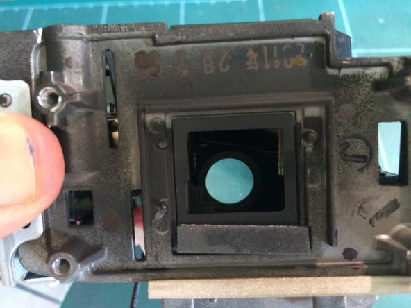

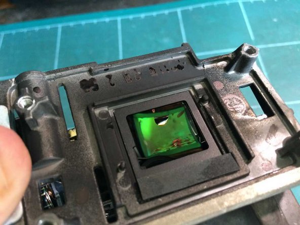

    9. Mitsubishi EX320U Projector Disassembly, Removing the DLP chip: crwdns2935265:09crwdnd2935265:01crwdnd2935265:02crwdne2935265:0 Mitsubishi EX320U Projector Disassembly, Removing the DLP chip: crwdns2935265:09crwdnd2935265:02crwdnd2935265:02crwdne2935265:0
      • Remove 4 screws and lift off the heat sink and DLP chip.
      • Inspect the DLP for any dust. You can wipe it gently with a cotton wool bud moistened with isopropyl alcohol.
      • Unless you are going to reassemble it immediately, put the DLP chip assembly in a clean polythene bag to protect it from dust.

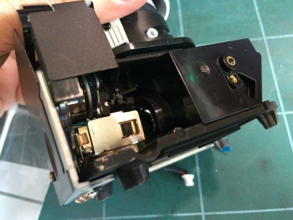

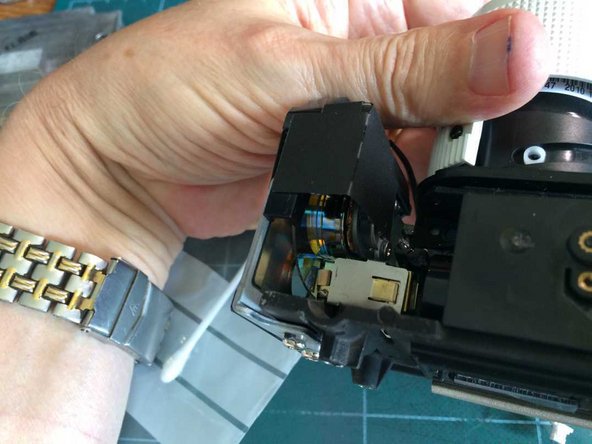

    10. Mitsubishi EX320U Projector Disassembly, Optical path - 1: crwdns2935265:010crwdnd2935265:01crwdnd2935265:03crwdne2935265:0 Mitsubishi EX320U Projector Disassembly, Optical path - 1: crwdns2935265:010crwdnd2935265:02crwdnd2935265:03crwdne2935265:0 Mitsubishi EX320U Projector Disassembly, Optical path - 1: crwdns2935265:010crwdnd2935265:03crwdnd2935265:03crwdne2935265:0
      • Follow the light path and inspect carefully for dust or contamination. These pictures show the optical assembly upside down.
      • Light enters from the lamp on the right, facing the screen (on the left in this picture since it's upside down).
      • The light then passes through the colour wheel ...
      • ... and into the collimator.
      • If dust or contamination has been sucked into the projector by the fan, it can deposit on and around the collimator, resulting in shadowy patches on the projected image.
    11. Mitsubishi EX320U Projector Disassembly, Optical path - 2: crwdns2935265:011crwdnd2935265:01crwdnd2935265:03crwdne2935265:0 Mitsubishi EX320U Projector Disassembly, Optical path - 2: crwdns2935265:011crwdnd2935265:02crwdnd2935265:03crwdne2935265:0 Mitsubishi EX320U Projector Disassembly, Optical path - 2: crwdns2935265:011crwdnd2935265:03crwdnd2935265:03crwdne2935265:0
      • The light enters the imaging chamber on the right (the left in the picture, as again, it's upside down).
      • The light is reflected off a mirror in the floor of the chamber, focussing it onto the DLP chip, which is located in the aperture we're looking through.
      • From the DLP chip, the light is reflected through the projection lens and hence on to the screen.
