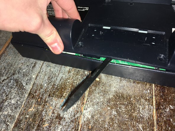

  3. Mitsubishi Diamondpoint NXM76LCD Speaker Replacement, Remove the back panel: crwdns2935265:03crwdnd2935265:01crwdnd2935265:03crwdne2935265:0 Mitsubishi Diamondpoint NXM76LCD Speaker Replacement, Remove the back panel: crwdns2935265:03crwdnd2935265:02crwdnd2935265:03crwdne2935265:0 Mitsubishi Diamondpoint NXM76LCD Speaker Replacement, Remove the back panel: crwdns2935265:03crwdnd2935265:03crwdnd2935265:03crwdne2935265:0
    • Lift the back and pry the back off.
    • The panel is held in with clips on the side. It needs a lot of force the take it off.

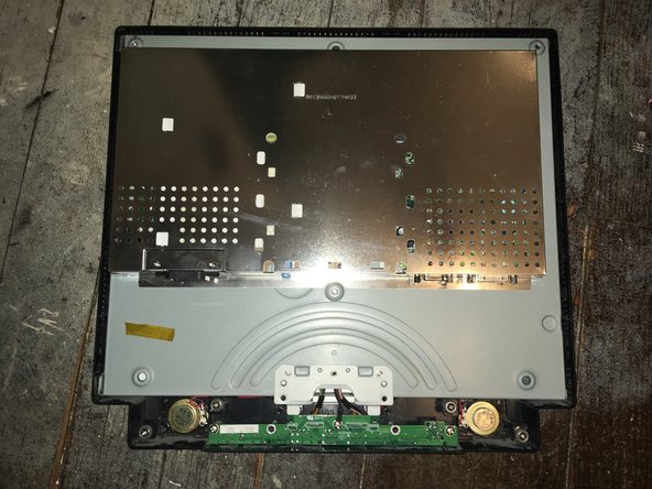

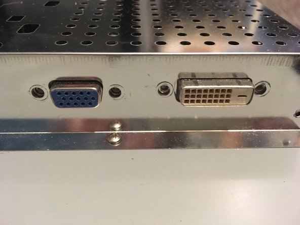

  4. Mitsubishi Diamondpoint NXM76LCD Speaker Replacement, Remove the four screws: crwdns2935265:04crwdnd2935265:01crwdnd2935265:02crwdne2935265:0 Mitsubishi Diamondpoint NXM76LCD Speaker Replacement, Remove the four screws: crwdns2935265:04crwdnd2935265:02crwdnd2935265:02crwdne2935265:0
    • Remove the four 5mm nut screws.
  5. Mitsubishi Diamondpoint NXM76LCD Speaker Replacement: crwdns2935265:05crwdnd2935265:01crwdnd2935265:02crwdne2935265:0 Mitsubishi Diamondpoint NXM76LCD Speaker Replacement: crwdns2935265:05crwdnd2935265:02crwdnd2935265:02crwdne2935265:0

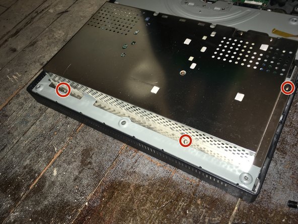

    • Remove the seven Phillips #1 screws.

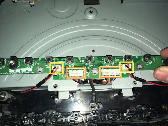

  6. Mitsubishi Diamondpoint NXM76LCD Speaker Replacement, Remove the front board: crwdns2935265:06crwdnd2935265:01crwdnd2935265:02crwdne2935265:0 Mitsubishi Diamondpoint NXM76LCD Speaker Replacement, Remove the front board: crwdns2935265:06crwdnd2935265:02crwdnd2935265:02crwdne2935265:0
    • Remove the three Phillips #2 screws.
    • Remove the two data/power cables.
    • Remove the two speaker cables.

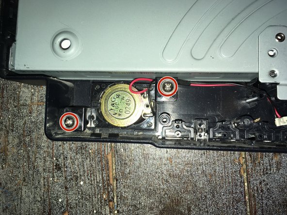

  7. Mitsubishi Diamondpoint NXM76LCD Speaker Replacement: crwdns2935265:07crwdnd2935265:01crwdnd2935265:02crwdne2935265:0 Mitsubishi Diamondpoint NXM76LCD Speaker Replacement: crwdns2935265:07crwdnd2935265:02crwdnd2935265:02crwdne2935265:0
    • Remove the Phillips #2 screws from the speaker(s).

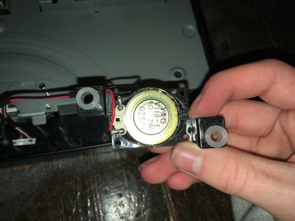

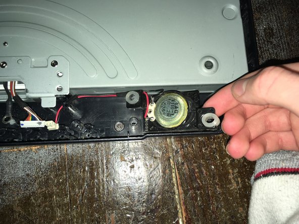

  8. Mitsubishi Diamondpoint NXM76LCD Speaker Replacement: crwdns2935265:08crwdnd2935265:01crwdnd2935265:03crwdne2935265:0 Mitsubishi Diamondpoint NXM76LCD Speaker Replacement: crwdns2935265:08crwdnd2935265:02crwdnd2935265:03crwdne2935265:0 Mitsubishi Diamondpoint NXM76LCD Speaker Replacement: crwdns2935265:08crwdnd2935265:03crwdnd2935265:03crwdne2935265:0
    • Pull the speaker off the slots.
