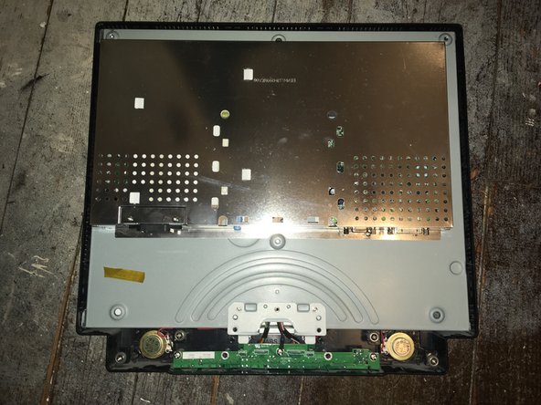

  1. Mitsubishi Diamondpoint NXM76LCD Motherboard Replacement, Removing the stand.: crwdns2935265:01crwdnd2935265:01crwdnd2935265:03crwdne2935265:0 Mitsubishi Diamondpoint NXM76LCD Motherboard Replacement, Removing the stand.: crwdns2935265:01crwdnd2935265:02crwdnd2935265:03crwdne2935265:0 Mitsubishi Diamondpoint NXM76LCD Motherboard Replacement, Removing the stand.: crwdns2935265:01crwdnd2935265:03crwdnd2935265:03crwdne2935265:0

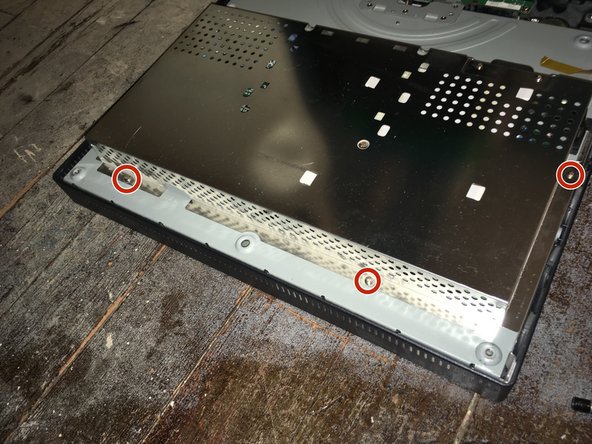

    • Lift the black cover off.
    • Remove all 4 Phillips #2 screws.
  2. Mitsubishi Diamondpoint NXM76LCD Motherboard Replacement, Remove the 5 screws: crwdns2935265:02crwdnd2935265:01crwdnd2935265:01crwdne2935265:0
    • Remove the two 24mm Phillips #2 screws.
    • Remove the three 8mm Phillips #2 screws.

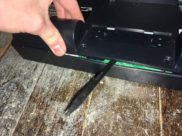

  3. Mitsubishi Diamondpoint NXM76LCD Motherboard Replacement, Remove the back panel: crwdns2935265:03crwdnd2935265:01crwdnd2935265:03crwdne2935265:0 Mitsubishi Diamondpoint NXM76LCD Motherboard Replacement, Remove the back panel: crwdns2935265:03crwdnd2935265:02crwdnd2935265:03crwdne2935265:0 Mitsubishi Diamondpoint NXM76LCD Motherboard Replacement, Remove the back panel: crwdns2935265:03crwdnd2935265:03crwdnd2935265:03crwdne2935265:0
    • Lift the back and pry the back off.
    • The panel is held in with clips on the side. It needs a lot of force the take it off.

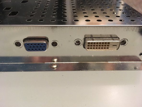

  4. Mitsubishi Diamondpoint NXM76LCD Motherboard Replacement, Remove the four screws: crwdns2935265:04crwdnd2935265:01crwdnd2935265:02crwdne2935265:0 Mitsubishi Diamondpoint NXM76LCD Motherboard Replacement, Remove the four screws: crwdns2935265:04crwdnd2935265:02crwdnd2935265:02crwdne2935265:0
    • Remove the four 5mm nut screws.
  5. Mitsubishi Diamondpoint NXM76LCD Motherboard Replacement, Remove the 5 screws: crwdns2935265:05crwdnd2935265:01crwdnd2935265:02crwdne2935265:0 Mitsubishi Diamondpoint NXM76LCD Motherboard Replacement, Remove the 5 screws: crwdns2935265:05crwdnd2935265:02crwdnd2935265:02crwdne2935265:0
    • Remove the seven Phillips #1 screws.

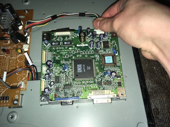

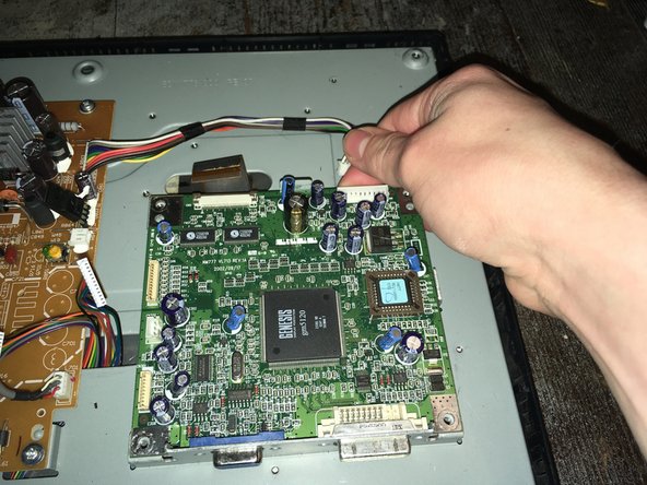

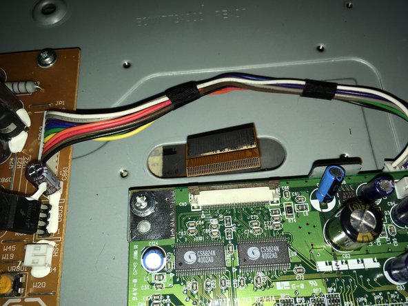

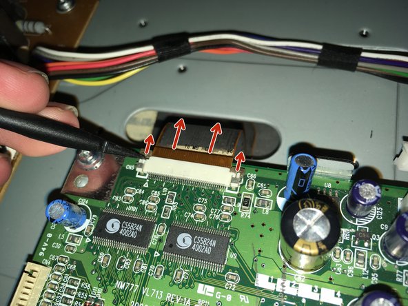

  6. Mitsubishi Diamondpoint NXM76LCD Motherboard Replacement, Remove the cables: crwdns2935265:06crwdnd2935265:01crwdnd2935265:03crwdne2935265:0 Mitsubishi Diamondpoint NXM76LCD Motherboard Replacement, Remove the cables: crwdns2935265:06crwdnd2935265:02crwdnd2935265:03crwdne2935265:0 Mitsubishi Diamondpoint NXM76LCD Motherboard Replacement, Remove the cables: crwdns2935265:06crwdnd2935265:03crwdnd2935265:03crwdne2935265:0
    • Remove all the cables.
  7. Mitsubishi Diamondpoint NXM76LCD Motherboard Replacement, Remove the motherboard: crwdns2935265:07crwdnd2935265:01crwdnd2935265:03crwdne2935265:0 Mitsubishi Diamondpoint NXM76LCD Motherboard Replacement, Remove the motherboard: crwdns2935265:07crwdnd2935265:02crwdnd2935265:03crwdne2935265:0 Mitsubishi Diamondpoint NXM76LCD Motherboard Replacement, Remove the motherboard: crwdns2935265:07crwdnd2935265:03crwdnd2935265:03crwdne2935265:0
    • Remove the four screws.
    • Pull the motherboard up and off.
  8. Mitsubishi Diamondpoint NXM76LCD Motherboard Replacement: crwdns2935265:08crwdnd2935265:01crwdnd2935265:01crwdne2935265:0
    • Now you can replace it with a new one.
