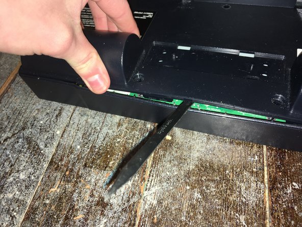

  3. Mitsubishi Diamondpoint NXM76LCD  Display  Replacement, Remove the back panel: crwdns2935265:03crwdnd2935265:01crwdnd2935265:03crwdne2935265:0 Mitsubishi Diamondpoint NXM76LCD  Display  Replacement, Remove the back panel: crwdns2935265:03crwdnd2935265:02crwdnd2935265:03crwdne2935265:0 Mitsubishi Diamondpoint NXM76LCD  Display  Replacement, Remove the back panel: crwdns2935265:03crwdnd2935265:03crwdnd2935265:03crwdne2935265:0
    • Lift the back and pry the back off.
    • The panel is held in with clips on the side. It needs a lot of force the take it off.

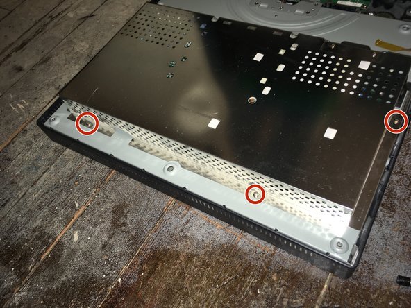

    • Remove the seven Phillips #1 screws.

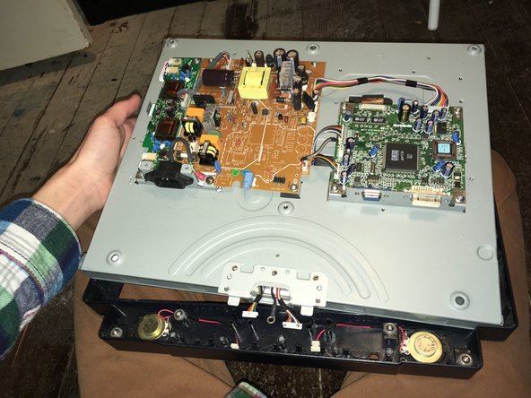

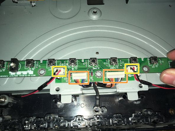

  6. Mitsubishi Diamondpoint NXM76LCD  Display  Replacement, Remove the front panel: crwdns2935265:06crwdnd2935265:01crwdnd2935265:02crwdne2935265:0 Mitsubishi Diamondpoint NXM76LCD  Display  Replacement, Remove the front panel: crwdns2935265:06crwdnd2935265:02crwdnd2935265:02crwdne2935265:0
    • Remove the three Phillips #2 screws.
    • Remove the two data/power cables.
    • Remove the two speaker cables.

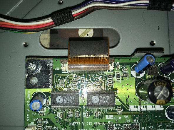

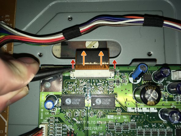

  7. Mitsubishi Diamondpoint NXM76LCD  Display  Replacement, Remove the display cable: crwdns2935265:07crwdnd2935265:01crwdnd2935265:03crwdne2935265:0 Mitsubishi Diamondpoint NXM76LCD  Display  Replacement, Remove the display cable: crwdns2935265:07crwdnd2935265:02crwdnd2935265:03crwdne2935265:0 Mitsubishi Diamondpoint NXM76LCD  Display  Replacement, Remove the display cable: crwdns2935265:07crwdnd2935265:03crwdnd2935265:03crwdne2935265:0
    • Pull the two tabs.
    • Pull the connector off.

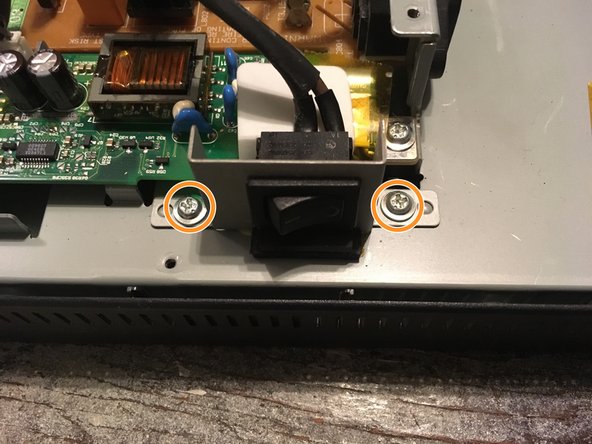

  8. Mitsubishi Diamondpoint NXM76LCD  Display  Replacement, Remove the power switch: crwdns2935265:08crwdnd2935265:01crwdnd2935265:02crwdne2935265:0 Mitsubishi Diamondpoint NXM76LCD  Display  Replacement, Remove the power switch: crwdns2935265:08crwdnd2935265:02crwdnd2935265:02crwdne2935265:0
    • Remove the switch cable off.
    • Remove the two Phillips #2 screws.

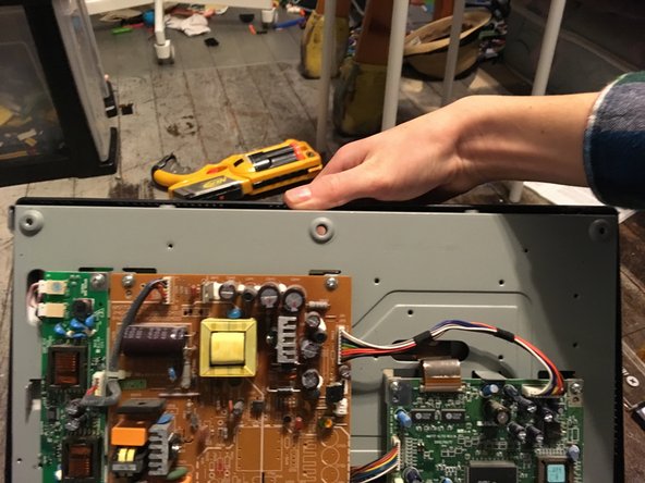

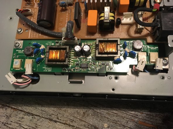

  9. Mitsubishi Diamondpoint NXM76LCD  Display  Replacement, Remove the display power: crwdns2935265:09crwdnd2935265:01crwdnd2935265:02crwdne2935265:0 Mitsubishi Diamondpoint NXM76LCD  Display  Replacement, Remove the display power: crwdns2935265:09crwdnd2935265:02crwdnd2935265:02crwdne2935265:0
    • Remove the four display power cables.
    • These cables are interchangeable.

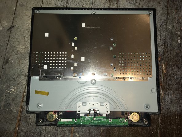

  10. Mitsubishi Diamondpoint NXM76LCD  Display  Replacement, Lift the display out: crwdns2935265:010crwdnd2935265:01crwdnd2935265:03crwdne2935265:0 Mitsubishi Diamondpoint NXM76LCD  Display  Replacement, Lift the display out: crwdns2935265:010crwdnd2935265:02crwdnd2935265:03crwdne2935265:0 Mitsubishi Diamondpoint NXM76LCD  Display  Replacement, Lift the display out: crwdns2935265:010crwdnd2935265:03crwdnd2935265:03crwdne2935265:0
    • Lift the display out.

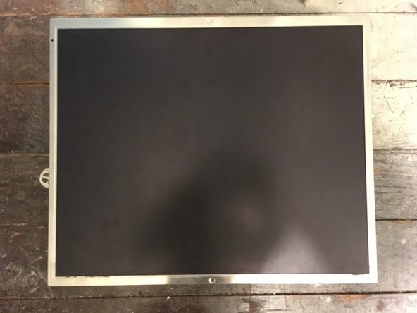

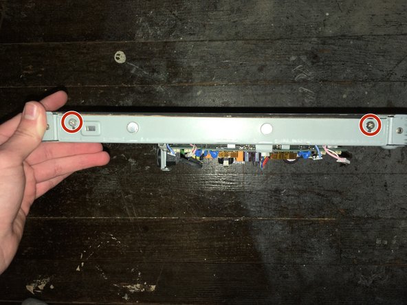

  11. Mitsubishi Diamondpoint NXM76LCD  Display  Replacement, Remove the four screws: crwdns2935265:011crwdnd2935265:01crwdnd2935265:02crwdne2935265:0 Mitsubishi Diamondpoint NXM76LCD  Display  Replacement, Remove the four screws: crwdns2935265:011crwdnd2935265:02crwdnd2935265:02crwdne2935265:0
    • Remove the four Phillips #2 screws.
    • These screws release the display from its enclosure. Hold the screen when removing these screws.
  12. Mitsubishi Diamondpoint NXM76LCD  Display  Replacement: crwdns2935265:012crwdnd2935265:01crwdnd2935265:02crwdne2935265:0 Mitsubishi Diamondpoint NXM76LCD  Display  Replacement: crwdns2935265:012crwdnd2935265:02crwdnd2935265:02crwdne2935265:0
    • Remember to plug in all the cables on the display.
