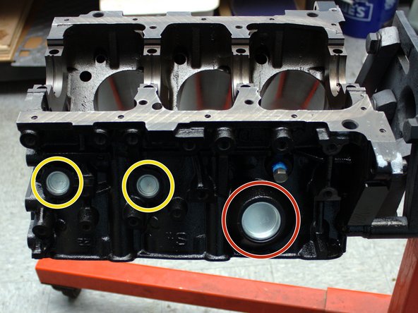

    • Install the following expansion plugs using a socket and hammer:
    • One 41.5mm plug (right side)
    • Two 35mm plugs (rear)
    • Five 25mm plugs (left and right sides)

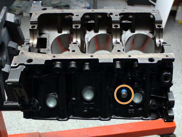

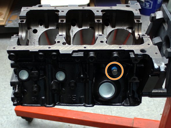

    • Install the two threaded hex plugs (front and rear) using an 8mm hex wrench.
    • Install the two threaded coolant plugs (left and right side) using a 14mm wrench.
    • Apply sealant or pipe tape to the plug threads.

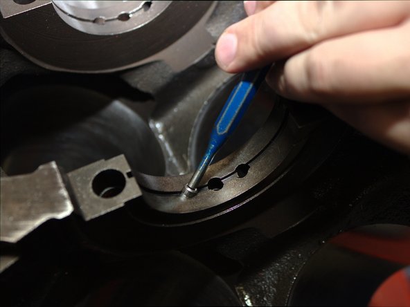

    • This step is for turbo engines only.

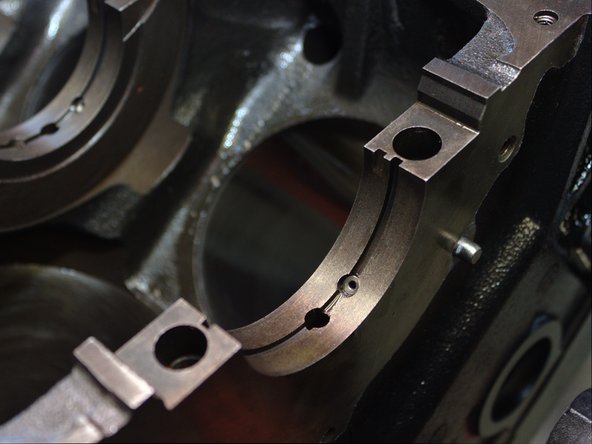

    • Install the six oil squirters into the angled holes in the main bearing journals using a punch and hammer.
    • Make sure each oil squirter is fully seated and below the bottom of the oil feed groove.
    • Do not install oil squirters in the center oil feed holes.

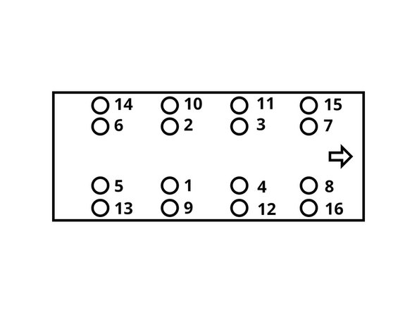

    • Use a torque wrench and a 17mm socket to tighten the main bolts to the specified torque:
    • Two-bolt blocks: 67 ft-lbs (93 Nm)
    • Four-bolt blocks: 54 ft-lbs (74 Nm)
    • Tighten bolts in the sequence shown.
