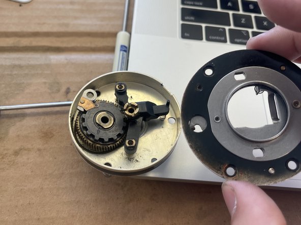

  3. Mitchell Epic Series E150 Disassembly, Removing the Center Body from the Handle Plate: crwdns2935265:03crwdnd2935265:01crwdnd2935265:01crwdne2935265:0
    • Loosen fasteners 4, 5, and 6 with a flat blade screwdriver.
    • Separate the center body of the reel from the handle plate.
    • Remove screw 9 holding in the retaining cap.

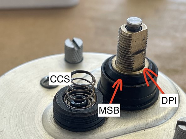

    • Remove cast control knob, CCK.
    • Remove cast control spring, CCS.
  8. Mitchell Epic Series E150 Disassembly, Removing Drag Assembly: crwdns2935265:08crwdnd2935265:01crwdnd2935265:03crwdne2935265:0 Mitchell Epic Series E150 Disassembly, Removing Drag Assembly: crwdns2935265:08crwdnd2935265:02crwdnd2935265:03crwdne2935265:0 Mitchell Epic Series E150 Disassembly, Removing Drag Assembly: crwdns2935265:08crwdnd2935265:03crwdnd2935265:03crwdne2935265:0

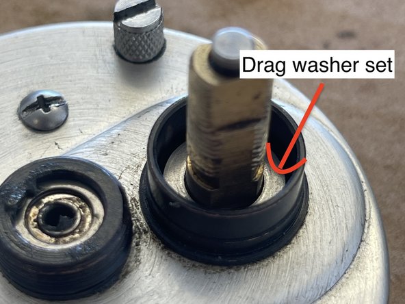

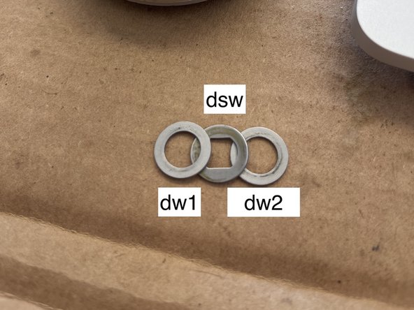

    • Remove main shaft bearing, MSB, drag pressure insert, DPI, drag washers, dw1, dw2, and drag spring washer, dsw.

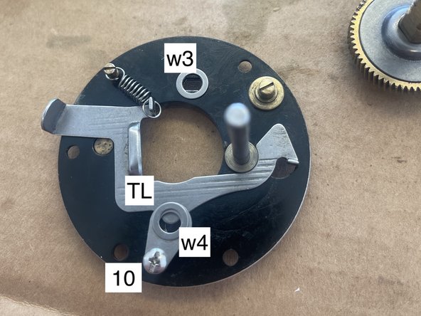

  10. Mitchell Epic Series E150 Disassembly, Removing Rotating Assembly: crwdns2935265:010crwdnd2935265:01crwdnd2935265:02crwdne2935265:0 Mitchell Epic Series E150 Disassembly, Removing Rotating Assembly: crwdns2935265:010crwdnd2935265:02crwdnd2935265:02crwdne2935265:0
    • Remove crankshaft assembly, CSA, and reverse lockout claw, RLC.
    • Slowly remove thumb latch, TL, to avoid losing the return spring.
    • Remove washers, w3,w4.
    • Remove screw, 10, holding down latch keeper.
  11. Mitchell Epic Series E150 Disassembly, Disassembling Drag Gears: crwdns2935265:011crwdnd2935265:01crwdnd2935265:01crwdne2935265:0
    • Remove drag pressure plate, DPP, from crankshaft assembly.
    • Remove main gear, MG from crankshaft assembly.

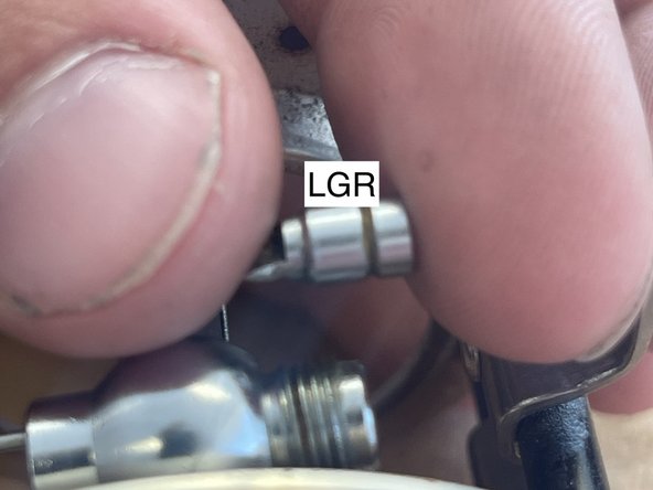

    • Remove line guide cap, LGC, with a flat blade screwdriver.
    • Remove line guide retainer, LGR.
    • Remove line guide gear retainer, LGGR, by pushing it off with a flat blade screwdriver.
  13. Mitchell Epic Series E150 Disassembly, Disassembling Line Guide: crwdns2935265:013crwdnd2935265:01crwdnd2935265:01crwdne2935265:0
    • Remove line guide bushing, LGB.
    • Remove line guide shaft, LGS, by pushing on the side that the line guide bushing was removed from.
