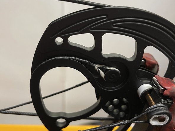

    • Align the arms of the bow press with the limbs of the bow.
    • Ensure the bow press and bow arms are safe to use for this particular bow.
  2. Mission Hammr Bow String and Cables Replacement: crwdns2935265:02crwdnd2935265:01crwdnd2935265:01crwdne2935265:0
    • Slowly compress the bow press until the string has some slack similar to what's shown in the picture.
    • DO NOT press the bow anymore than you have to. This could result in damage to the bow and the bow press.
  3. Mission Hammr Bow String and Cables Replacement: crwdns2935265:03crwdnd2935265:01crwdnd2935265:01crwdne2935265:0
    • Before you remove the string or cables make sure you know where everything goes for replacement. Take a picture if needed.
  4. Mission Hammr Bow String and Cables Replacement: crwdns2935265:04crwdnd2935265:01crwdnd2935265:01crwdne2935265:0
    • Remove the string.
    • This is the easiest piece to put on and take off. Taking this off first will keep it out of the way so you can access the cables a bit more cleanly.
  5. Mission Hammr Bow String and Cables Replacement: crwdns2935265:05crwdnd2935265:01crwdnd2935265:03crwdne2935265:0 Mission Hammr Bow String and Cables Replacement: crwdns2935265:05crwdnd2935265:02crwdnd2935265:03crwdne2935265:0 Mission Hammr Bow String and Cables Replacement: crwdns2935265:05crwdnd2935265:03crwdnd2935265:03crwdne2935265:0
    • Now remove the cables one at a time.
    • After removing an old cable, immediately replace it with a new one. Doing this will make it easier to ensure you are replacing the cables in the correct spots.
    • The place the cable hooks onto the cam is labeled with a C. The string goes where it's imprinted with an S.
  6. Mission Hammr Bow String and Cables Replacement: crwdns2935265:06crwdnd2935265:01crwdnd2935265:01crwdne2935265:0
    • Once both sets of cables are replaced, make sure they are in the correct grooves before continuing.
  7. Mission Hammr Bow String and Cables Replacement: crwdns2935265:07crwdnd2935265:01crwdnd2935265:02crwdne2935265:0 Mission Hammr Bow String and Cables Replacement: crwdns2935265:07crwdnd2935265:02crwdnd2935265:02crwdne2935265:0
    • Replace the string.
  8. Mission Hammr Bow String and Cables Replacement: crwdns2935265:08crwdnd2935265:01crwdnd2935265:01crwdne2935265:0
    • Now with the string on and in the correct groove check through everything once more.
    • With the bow press, slowly tighten the strings and cables until it looks like it did before the replacement.
    • Use your before picture for a comparison to make sure it's correct.
  9. Mission Hammr Bow String and Cables Replacement: crwdns2935265:09crwdnd2935265:01crwdnd2935265:01crwdne2935265:0
    • Now with the pressure back on the bow everything should be ready to go.
    • Double check to make sure the cables align in the tuning holes and the strings and cables have successfully been replaced.
