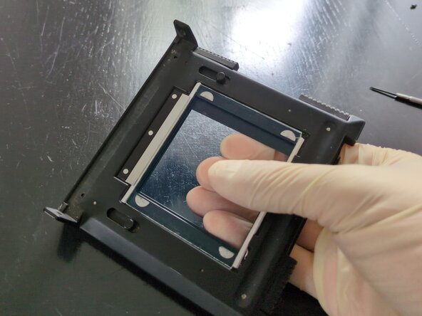

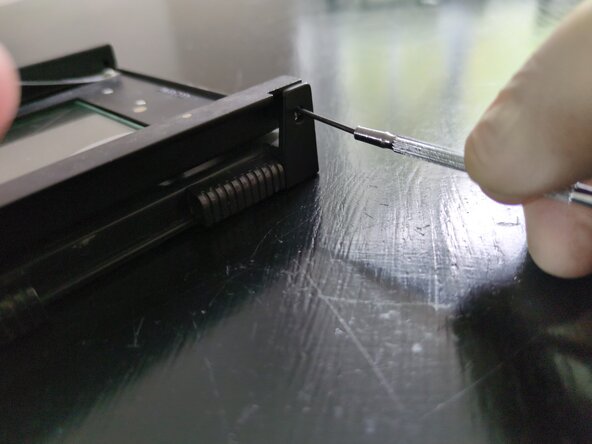

    • Dissemble the negative carrier by unscrewing it at the hinge
    • Select one part of the negative carrier to work on. Store the other one in a secure location
    • The image of the lower half of the carrier shows the already replaced glasses. I'll try to supply better photos for documentation

  3. Miscellaneous Electronics Durst Sironeg glass inserts Replacement, Measure glasses: crwdns2935265:03crwdnd2935265:01crwdnd2935265:01crwdne2935265:0
    • Use a ruler to measure glasses
    • Note that the glasses are beveled along the long edges. This is how the are secured in the negative holder
    • Take the following measurements:
    • Total size of the glasses. In my case: 75 x 65 mm
    • Size of the glasses without the bevels. In my case: 75 x 60 mm
    • Procure the needed glases
    • If you can get beveled glasses, get the measured total size
    • If you can only get even edges, get the smaller measured size
    • You can also cut the glasses from a bigger sheet of glass.
    • Use the appropriate PSA when cutting glas!
    • Instructions can be found here
  4. Miscellaneous Electronics Durst Sironeg glass inserts Replacement, Cut bevels from sheet material: crwdns2935265:05crwdnd2935265:01crwdnd2935265:01crwdne2935265:0
    • Grinding glass is a dangerous and tedious business. Use an alternative material to add the bevels to the glass
    • I have used a precut matte for framing photographs and artwork
    • Use material with lesser thickness than the used glasses
    • Add a 45° bevel to the edge of your material. In case of a matte use the prepared edges of the cutout
    • Cut a small strip of material that includes the bevel. Choose the with of the strip appropriately to match the total size of the glasses when you add to of the strips to the long edges
  5. Miscellaneous Electronics Durst Sironeg glass inserts Replacement, Glue bevels to the glasses: crwdns2935265:06crwdnd2935265:01crwdnd2935265:01crwdne2935265:0
    • Cut a strip of double sided adhesive tape that matches the glass thickness
    • Apply the adhesive to the long edges of the glas
    • Remove the securing layer of the adhesive tape
    • Firmly press one of your bevel strips to the glued edge to join the parts
    • Glue the bevels for the upper part of the negative carrier so that the etched side of the glass faces towards the negative!
    • You can see the glued bevels at the top and bottom of the glass in the picture
    • Slide the top edge of the glass under the metal spring on the negative carier
    • Make sure not to indent the bevel material if you have choosen a soft alternative like matte board
    • Slide the bottom bevel under the holders on the bottom side of the negative carrier
