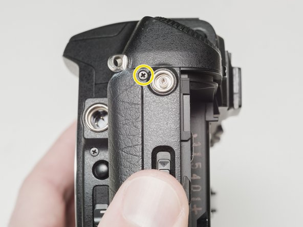

    3. Mirror Box Removal, Remove top cover screws: crwdns2935265:03crwdnd2935265:01crwdnd2935265:03crwdne2935265:0 Mirror Box Removal, Remove top cover screws: crwdns2935265:03crwdnd2935265:02crwdnd2935265:03crwdne2935265:0 Mirror Box Removal, Remove top cover screws: crwdns2935265:03crwdnd2935265:03crwdnd2935265:03crwdne2935265:0
      • Push the button to pop up the flash.
      • Remove one 3.5 mm #00 screw.
      • Remove one 5.5 mm #00 screw.

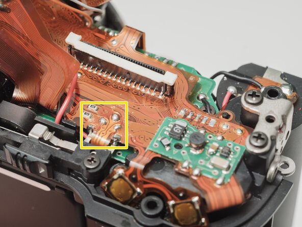

    8. Mirror Box Removal, Disconnect left flex cable: crwdns2935265:08crwdnd2935265:01crwdnd2935265:01crwdne2935265:0
      • Desolder the red wire.
      • Carefully lift the sides of the white latch.
      • Hold the flex PCB on the camera body in place as you lift to prevent damaging the flex.

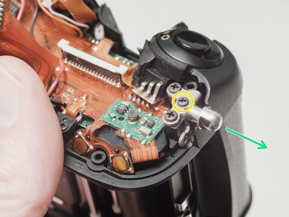

    3. Mirror Box Removal, Remove front cover: crwdns2935265:013crwdnd2935265:01crwdnd2935265:01crwdne2935265:0
      • Remove front cover.
    4. Mirror Box Removal, Unscrew front right cover: crwdns2935265:014crwdnd2935265:01crwdnd2935265:03crwdne2935265:0 Mirror Box Removal, Unscrew front right cover: crwdns2935265:014crwdnd2935265:02crwdnd2935265:03crwdne2935265:0 Mirror Box Removal, Unscrew front right cover: crwdns2935265:014crwdnd2935265:03crwdnd2935265:03crwdne2935265:0
      • Remove one 6.0 mm #00 screw.
      • Remove two 3.5 mm #00 screws.
      • Remove one 5.0 mm #00 screw.
      • Remove the strap lug.

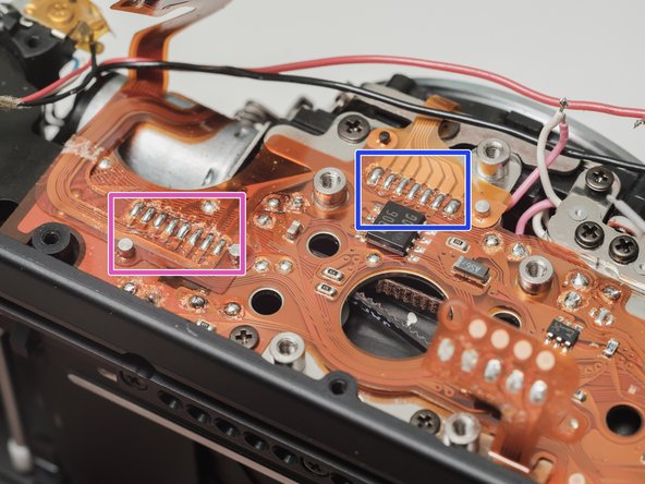

    4. Mirror Box Removal, Desolder connections to top flex circuit: crwdns2935265:019crwdnd2935265:01crwdnd2935265:03crwdne2935265:0 Mirror Box Removal, Desolder connections to top flex circuit: crwdns2935265:019crwdnd2935265:02crwdnd2935265:03crwdne2935265:0 Mirror Box Removal, Desolder connections to top flex circuit: crwdns2935265:019crwdnd2935265:03crwdnd2935265:03crwdne2935265:0
      • Desolder red, black, gray and orange wires.
      • Desolder flex contacts.
      • Disconnect flex connector.
      • Desolder yellow and purple wires.

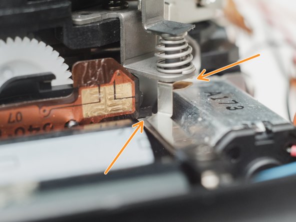

    9. Mirror Box Removal, Flip the mirror up: crwdns2935265:024crwdnd2935265:01crwdnd2935265:02crwdne2935265:0 Mirror Box Removal, Flip the mirror up: crwdns2935265:024crwdnd2935265:02crwdnd2935265:02crwdne2935265:0
      • Rotate the black gear downward until the mirror flips up into the taking position. It may take several turns.
      • Some failures will result in the mirror appearing to be in the upper position but the internal mechanism is still "down". The mechanism needs to be moved to release the mirror box.

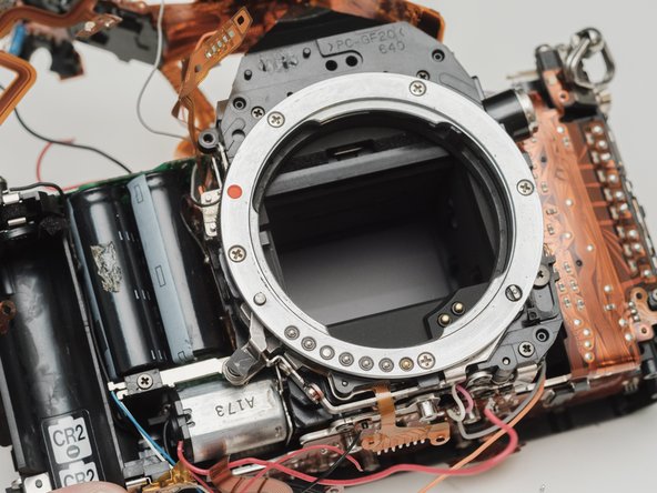

    12. Mirror Box Removal, Remove the mirror box: crwdns2935265:027crwdnd2935265:01crwdnd2935265:02crwdne2935265:0 Mirror Box Removal, Remove the mirror box: crwdns2935265:027crwdnd2935265:02crwdnd2935265:02crwdne2935265:0
      • Push the mirror box up to free it from the bottom plate.
      • Lift the left side of the mirror box and rotate it up and out of the camera body.
      • Be gentle. Keep an eye out for any snagged flex cables or wires. The right side of the mirror box is still connected to the camera body and it cannot be completely removed.
      • Check for shim washers at the mount locations. Note location and remove if loose.
