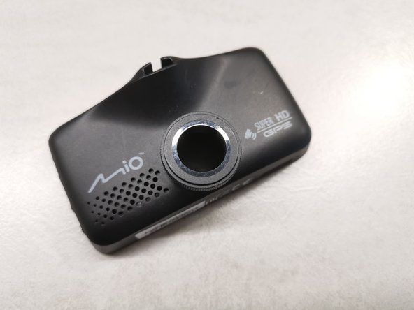

    • We will disassemble Mio MiVue 698 (Dual) car camera in this guide.
    • On the top of the unit, under the two caps, there are two Philips screws. Remove those caps and use Philips 0 screwdriver.

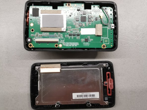

  2. Mio MiVue 698 Disassembly, Open it up: crwdns2935265:02crwdnd2935265:01crwdnd2935265:03crwdne2935265:0 Mio MiVue 698 Disassembly, Open it up: crwdns2935265:02crwdnd2935265:02crwdnd2935265:03crwdne2935265:0 Mio MiVue 698 Disassembly, Open it up: crwdns2935265:02crwdnd2935265:03crwdnd2935265:03crwdne2935265:0
    • Now use a prying tool and gently pry all four sides of the display assembly.
    • Be careful not to damage the wire strip on the bottom.

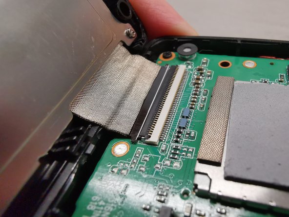

  3. Mio MiVue 698 Disassembly, Remove wires: crwdns2935265:03crwdnd2935265:01crwdnd2935265:03crwdne2935265:0 Mio MiVue 698 Disassembly, Remove wires: crwdns2935265:03crwdnd2935265:02crwdnd2935265:03crwdne2935265:0 Mio MiVue 698 Disassembly, Remove wires: crwdns2935265:03crwdnd2935265:03crwdnd2935265:03crwdne2935265:0
    • Remove black adhesive tape from the contacts.
    • Use a plastic tweezers to gently unlock wire strip from the contacts. You will end up with a disconnected display assembly.

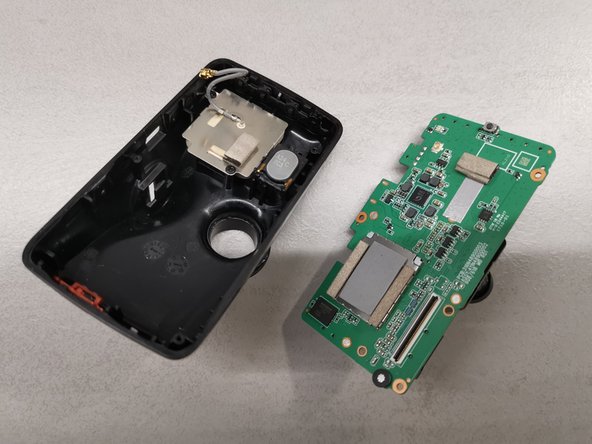

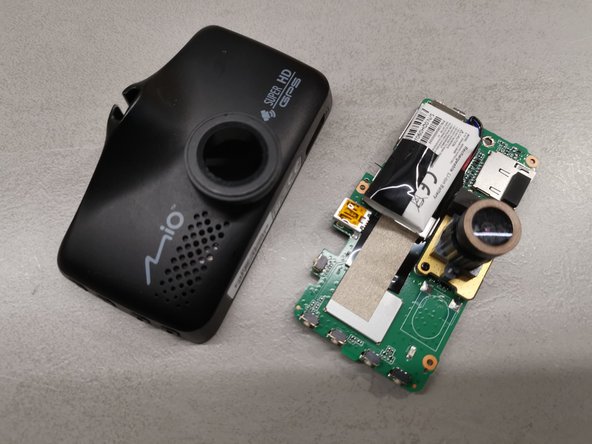

  4. Mio MiVue 698 Disassembly, Remove board from the case: crwdns2935265:04crwdnd2935265:01crwdnd2935265:03crwdne2935265:0 Mio MiVue 698 Disassembly, Remove board from the case: crwdns2935265:04crwdnd2935265:02crwdnd2935265:03crwdne2935265:0 Mio MiVue 698 Disassembly, Remove board from the case: crwdns2935265:04crwdnd2935265:03crwdnd2935265:03crwdne2935265:0
    • Disconnect the grey wire, which leads to GPS module.
    • Remove three screws that hold the PCB.
    • Remove the microSD card from the unit. Now you have to use a finger to carefully push against the lens from the front of the car camera, so the board will pop out.

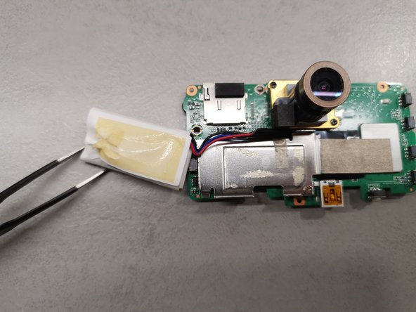

  5. Mio MiVue 698 Disassembly, Remove battery: crwdns2935265:05crwdnd2935265:01crwdnd2935265:02crwdne2935265:0 Mio MiVue 698 Disassembly, Remove battery: crwdns2935265:05crwdnd2935265:02crwdnd2935265:02crwdne2935265:0
    • The battery is attached to the board with a small piece of tape.

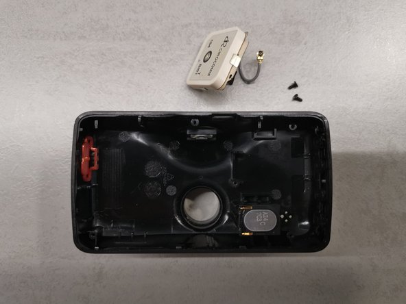

  6. Mio MiVue 698 Disassembly, Remove GPS module: crwdns2935265:06crwdnd2935265:01crwdnd2935265:03crwdne2935265:0 Mio MiVue 698 Disassembly, Remove GPS module: crwdns2935265:06crwdnd2935265:02crwdnd2935265:03crwdne2935265:0 Mio MiVue 698 Disassembly, Remove GPS module: crwdns2935265:06crwdnd2935265:03crwdnd2935265:03crwdne2935265:0
    • Remove two screws so you can remove the GPS module.
