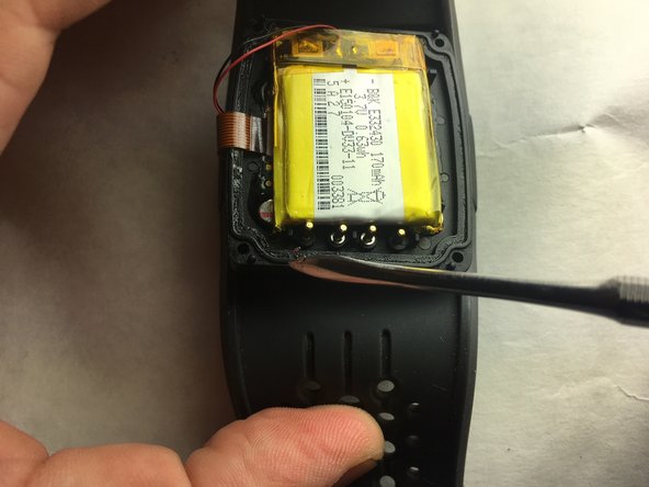

    • Remove the four 6.7mm JIS #00 screws from the back cover.
  2. Mio Alpha 2 Charging Pins Replacement: crwdns2935265:02crwdnd2935265:01crwdnd2935265:02crwdne2935265:0 Mio Alpha 2 Charging Pins Replacement: crwdns2935265:02crwdnd2935265:02crwdnd2935265:02crwdne2935265:0
    • Remove the gold coils from the bottom of the pin. Remove the washer from the pin with the spudger.
  3. Mio Alpha 2 Charging Pins Replacement: crwdns2935265:03crwdnd2935265:01crwdnd2935265:02crwdne2935265:0 Mio Alpha 2 Charging Pins Replacement: crwdns2935265:03crwdnd2935265:02crwdnd2935265:02crwdne2935265:0
    • Pop the pins out one at a time using the spudger.
