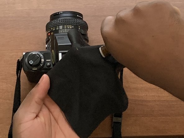

    • Using your hands unscrew the top of the film advance lever.
    • Afterward, you will be able to access the lever. Remove the lever by picking it up vertically.

    • Using a microfiber wipe, clean the gears with gear oil.
    • After oiling, place a new lever and top back the camera.
