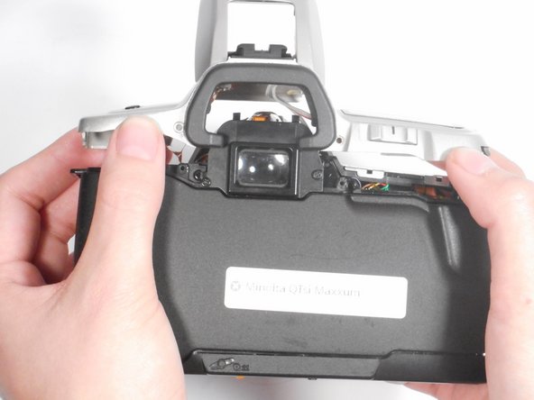

  6. Minolta QTsi Maxxum View Finder Replacement: crwdns2935265:06crwdnd2935265:01crwdnd2935265:02crwdne2935265:0 Minolta QTsi Maxxum View Finder Replacement: crwdns2935265:06crwdnd2935265:02crwdnd2935265:02crwdne2935265:0
    • Once all screws are removed, the top of the camera should come off easily.
    • Be careful when removing the top, there are wires connected that could be damaged.
  7. Minolta QTsi Maxxum View Finder Replacement: crwdns2935265:07crwdnd2935265:01crwdnd2935265:01crwdne2935265:0
    • The viewfinder will fall when the screws are removed.
    • Remove the (2) black Phillips #00 5mm screws that hold the viewfinder.
    • Be careful because the screws are small and easy to lose.
