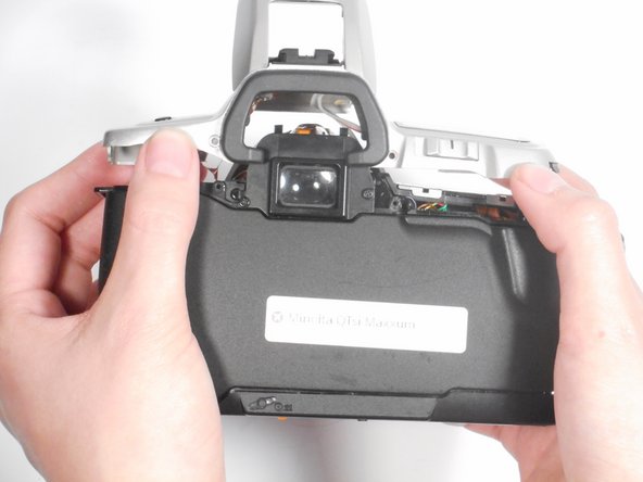

    • The only screws remaining that hold the top panel of the camera in place are located next to the view finder.
    • Remove the (2) black Phillips #00 5mm screws from both sides of the view finder.
    • Be careful because you can lose the screw
  6. Minolta QTsi Maxxum Shutter Button Replacement: crwdns2935265:06crwdnd2935265:01crwdnd2935265:02crwdne2935265:0 Minolta QTsi Maxxum Shutter Button Replacement: crwdns2935265:06crwdnd2935265:02crwdnd2935265:02crwdne2935265:0
    • The top panel of the camera should now be easy to lift off. If it is not, make sure that all screws and attachments, listed in steps 1-5, have been removed.
    • Once all screws are removed, lift the top panel from the camera.
    • Be careful when removing the top panel because there are wires connected to it.
  7. Minolta QTsi Maxxum Shutter Button Replacement: crwdns2935265:07crwdnd2935265:01crwdnd2935265:01crwdne2935265:0
    • Use a metal spudger to push the button out of its socket so that you can place a new one in its place.
