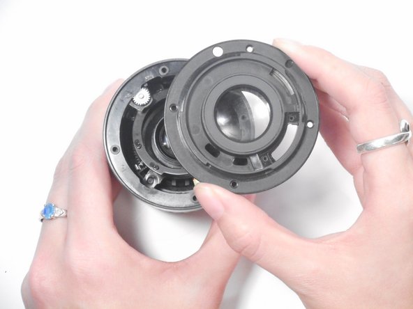

  2. Minolta QTsi Maxxum Lens Replacement: crwdns2935265:02crwdnd2935265:01crwdnd2935265:01crwdne2935265:0
    • The detached module has multiple screws that must be removed in order to reach the lens.
    • Once detached, remove the (4) black Phillips #00 5mm screws from the outer rim of the module.
    • Next, remove the (2) remaining black Phillips #00 5mm screws.
  3. Minolta QTsi Maxxum Lens Replacement: crwdns2935265:03crwdnd2935265:01crwdnd2935265:02crwdne2935265:0 Minolta QTsi Maxxum Lens Replacement: crwdns2935265:03crwdnd2935265:02crwdnd2935265:02crwdne2935265:0
    • Once all screws have been removed, take the back piece off of the lens and replace it.
    • This piece should come off easily without using any tools.
    • There is film underneath the last 2 screws that are removed so be careful when taking it out because it could rip.
