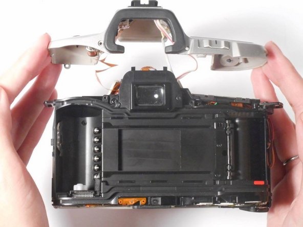

  10. Minolta QTsi Maxxum Eyelet Straps Replacement: crwdns2935265:010crwdnd2935265:01crwdnd2935265:02crwdne2935265:0 Minolta QTsi Maxxum Eyelet Straps Replacement: crwdns2935265:010crwdnd2935265:02crwdnd2935265:02crwdne2935265:0
    • The top panel of the camera should now be easy to pop off. If it is not, make sure that all screws listed in steps 3-9 are removed.
    • Lift the top panel away from the rest of the camera.
    • Be careful when removing the top panel because there are wires connected to it.
  11. Minolta QTsi Maxxum Eyelet Straps Replacement: crwdns2935265:011crwdnd2935265:01crwdnd2935265:01crwdne2935265:0
    • Once all parts of the camera are removed, both eyelet straps should be visible on the top left and right sides.
    • Unscrew the (4) black Phillips #00 5mm screws to remove each eyelet strap holder and replace them.
