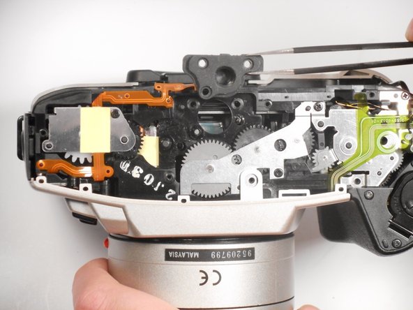

    • With a screwdriver, remove the (7) black Phillips #00 5.0mm screws on the bottom of the camera.
    • The screws are located on the outer edge of the bottom panel.
    • Be careful when removing the screws from the panel because they are easy to lose.
  2. Minolta Maxxum QTSI Tripod Mount Replacement: crwdns2935265:02crwdnd2935265:01crwdnd2935265:02crwdne2935265:0 Minolta Maxxum QTSI Tripod Mount Replacement: crwdns2935265:02crwdnd2935265:02crwdnd2935265:02crwdne2935265:0
    • Once all the screws are removed, the panel should easily come off.
    • Remove the bottom panel of the camera by placing your index finger and thumb on the outer edges of the panel.
    • Pull the bottom panel towards you, it should come off easily.
  3. Minolta Maxxum QTSI Tripod Mount Replacement: crwdns2935265:03crwdnd2935265:01crwdnd2935265:01crwdne2935265:0
    • The tripod socket is visible when the bottom panel is removed.
    • Remove the (3) black Phillips #00 6.25mm screws from the tripod socket.
    • When the screws are removed, the tripod socket is free and can easily be lost.
  4. Minolta Maxxum QTSI Tripod Mount Replacement: crwdns2935265:04crwdnd2935265:01crwdnd2935265:02crwdne2935265:0 Minolta Maxxum QTSI Tripod Mount Replacement: crwdns2935265:04crwdnd2935265:02crwdnd2935265:02crwdne2935265:0
    • Use the tweezers to gently remove the tripod socket, and replace it.
