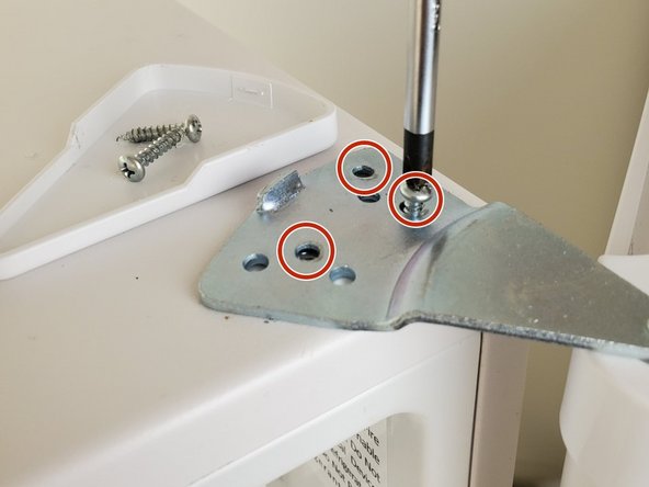

  3. Mini Fridge Hinges Replacement: crwdns2935265:03crwdnd2935265:01crwdnd2935265:02crwdne2935265:0 Mini Fridge Hinges Replacement: crwdns2935265:03crwdnd2935265:02crwdnd2935265:02crwdne2935265:0
    • Remove the cover to the top hinge to access the hinge and screws. If you are unable to remove the cover with your hands, use a flathead screwdriver to pry it off.
    • Remove the three 20 mm Phillips #1 screws from beneath the cover.

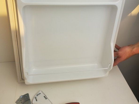

  4. Mini Fridge Hinges Replacement: crwdns2935265:04crwdnd2935265:01crwdnd2935265:03crwdne2935265:0 Mini Fridge Hinges Replacement: crwdns2935265:04crwdnd2935265:02crwdnd2935265:03crwdne2935265:0 Mini Fridge Hinges Replacement: crwdns2935265:04crwdnd2935265:03crwdnd2935265:03crwdne2935265:0
    • After removing the top hinge, lift the door off of the bottom hinge.
    • Place the door and removed top hinge securely to the side.

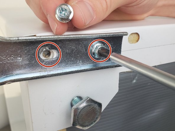

  5. Mini Fridge Hinges Replacement: crwdns2935265:05crwdnd2935265:01crwdnd2935265:02crwdne2935265:0 Mini Fridge Hinges Replacement: crwdns2935265:05crwdnd2935265:02crwdnd2935265:02crwdne2935265:0
    • Rotate the fridge onto its side.
    • Do not turn the fridge upside down to protect the internal components of the fridge.
    • Remove the two 19 mm Phillips #1 screws and the bottom hinge.
