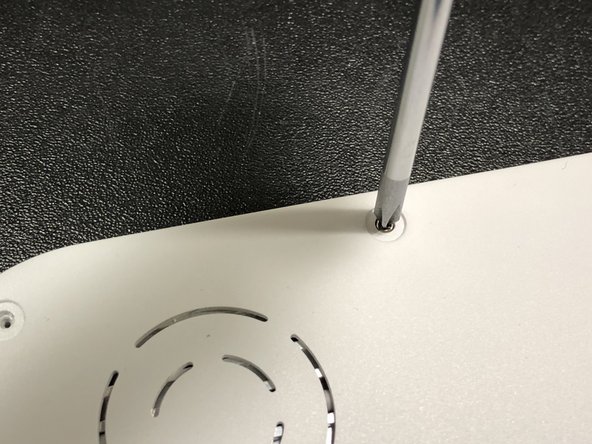

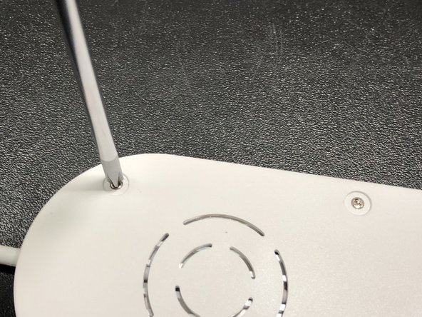

  3. Mini AirPower Wireless Charger Teardown.: crwdns2935265:03crwdnd2935265:01crwdnd2935265:03crwdne2935265:0 Mini AirPower Wireless Charger Teardown.: crwdns2935265:03crwdnd2935265:02crwdnd2935265:03crwdne2935265:0 Mini AirPower Wireless Charger Teardown.: crwdns2935265:03crwdnd2935265:03crwdnd2935265:03crwdne2935265:0
    • Remove the six 5 mm philips head screws.

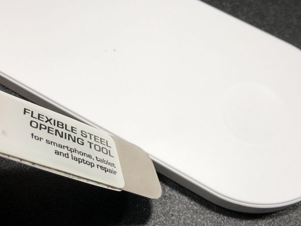

  4. Mini AirPower Wireless Charger Teardown.: crwdns2935265:04crwdnd2935265:01crwdnd2935265:03crwdne2935265:0 Mini AirPower Wireless Charger Teardown.: crwdns2935265:04crwdnd2935265:02crwdnd2935265:03crwdne2935265:0 Mini AirPower Wireless Charger Teardown.: crwdns2935265:04crwdnd2935265:03crwdnd2935265:03crwdne2935265:0
    • Turn the charger with the front up and insert a iSesamo between the gap.

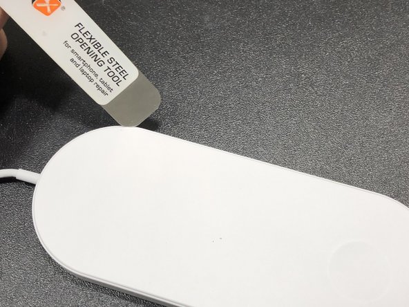

  5. Mini AirPower Wireless Charger Teardown.: crwdns2935265:05crwdnd2935265:01crwdnd2935265:01crwdne2935265:0
    • Separate the top from the body

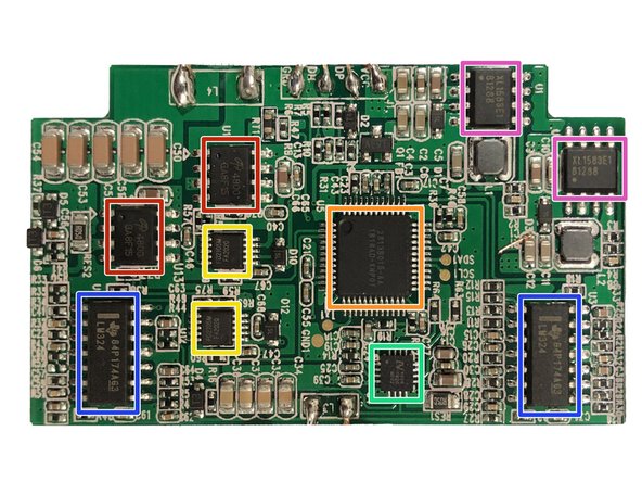

  6. Mini AirPower Wireless Charger Teardown.: crwdns2935265:06crwdnd2935265:01crwdnd2935265:02crwdne2935265:0 Mini AirPower Wireless Charger Teardown.: crwdns2935265:06crwdnd2935265:02crwdnd2935265:02crwdne2935265:0
    • 4800 GA8F15 - Dual N-Channel MOSFET Datasheet
    • FD2105M FA2020 - Half Bridge Driver Datasheet
    • 84P174A63 LM324 - Quadruple Operational Amplifiers Datasheet
    • 1818AD-XNPOT - Unknown IC no data on internet found.
    • XL1583E1 81288 - Buck DC to DC Converter Datasheet
    • 1006 1820 N002 - Unknown IC no data on internet found.
