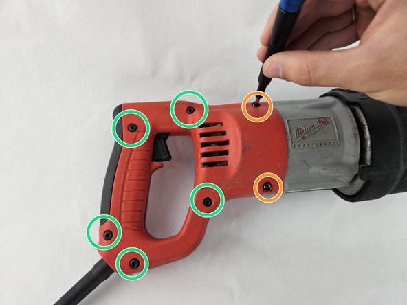

    • Unplug the Sawzall and Orient the right half-handle to face upwards.
    • With a T20 Torx screwdriver, remove the following screws:
    • 7-18 x 1.125-inch Slt. Plastite T-20
    • 8-16 x .625-inch Slt. Plastite T-20

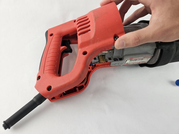

    • The right-half handle does not contain any wires on the underside.
    • Lift the handle off.

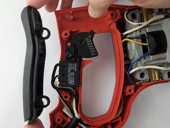

  2. Milwaukee Sawzall 6520-21 Power Cord Replacement: crwdns2935265:02crwdnd2935265:01crwdnd2935265:02crwdne2935265:0 Milwaukee Sawzall 6520-21 Power Cord Replacement: crwdns2935265:02crwdnd2935265:02crwdnd2935265:02crwdne2935265:0
    • Two rubber rings around the divots hold the cushion grip to the handle.
    • Lift off the cushion grip.

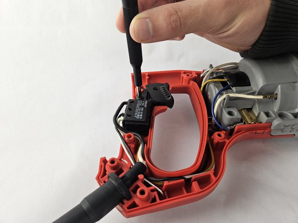

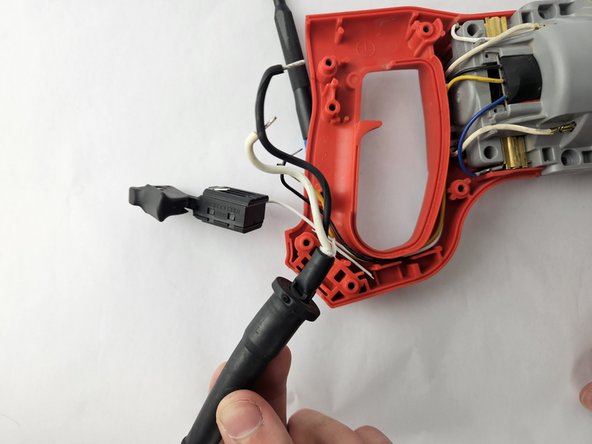

  3. Milwaukee Sawzall 6520-21 Power Cord Replacement: crwdns2935265:03crwdnd2935265:01crwdnd2935265:02crwdne2935265:0 Milwaukee Sawzall 6520-21 Power Cord Replacement: crwdns2935265:03crwdnd2935265:02crwdnd2935265:02crwdne2935265:0
    • Remove the screw above the trigger.
    • 8-16 x .625-inch
    • The trigger wires threaded through the handle are not fastened. They do not require any tool to pull out.

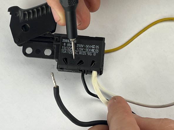

  4. Milwaukee Sawzall 6520-21 Power Cord Replacement: crwdns2935265:04crwdnd2935265:01crwdnd2935265:03crwdne2935265:0 Milwaukee Sawzall 6520-21 Power Cord Replacement: crwdns2935265:04crwdnd2935265:02crwdnd2935265:03crwdne2935265:0 Milwaukee Sawzall 6520-21 Power Cord Replacement: crwdns2935265:04crwdnd2935265:03crwdnd2935265:03crwdne2935265:0
    • Take a 1.5mm flathead screwdriver and insert it into the pin lock above each of the wires:
    • Black wire: Insert it on the left side of the pin. Pull the wire while gently rotating it clockwise
    • Black wire: Insert it on the bottom side of the pin and gently rotate it counterclockwise
    • White wire: Insert it on the right of the pin and gently rotate it counterclockwise
