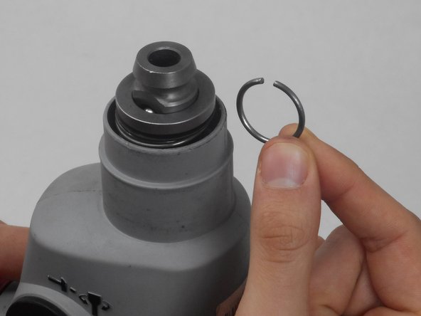

  11. Milwaukee Rotary Hammer 260520 D14A 2016 Gasket Replacement, Gasket: crwdns2935265:011crwdnd2935265:01crwdnd2935265:02crwdne2935265:0 Milwaukee Rotary Hammer 260520 D14A 2016 Gasket Replacement, Gasket: crwdns2935265:011crwdnd2935265:02crwdnd2935265:02crwdne2935265:0
    • Using the iFixit Opening Tool, pry the C-ring off the drill.

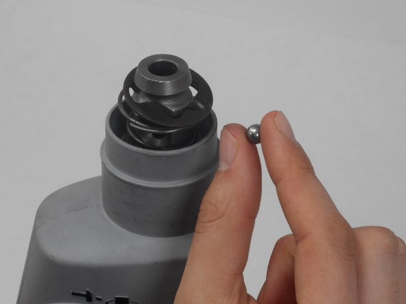

  13. Milwaukee Rotary Hammer 260520 D14A 2016 Gasket Replacement: crwdns2935265:013crwdnd2935265:01crwdnd2935265:02crwdne2935265:0 Milwaukee Rotary Hammer 260520 D14A 2016 Gasket Replacement: crwdns2935265:013crwdnd2935265:02crwdnd2935265:02crwdne2935265:0
    • Turn the drill so that it points downwards. Push in the ball support plate so that the 7 mm ball falls out.
    • The ball may fall out unexpectedly. Make sure you are attentive and have a clean workspace.

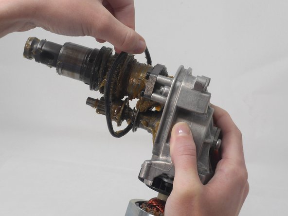

  18. Milwaukee Rotary Hammer 260520 D14A 2016 Gasket Replacement: crwdns2935265:018crwdnd2935265:01crwdnd2935265:02crwdne2935265:0 Milwaukee Rotary Hammer 260520 D14A 2016 Gasket Replacement: crwdns2935265:018crwdnd2935265:02crwdnd2935265:02crwdne2935265:0
    • Remove the drill from the grey gear housing.
    • Remove the damaged gasket from the crankcase.
