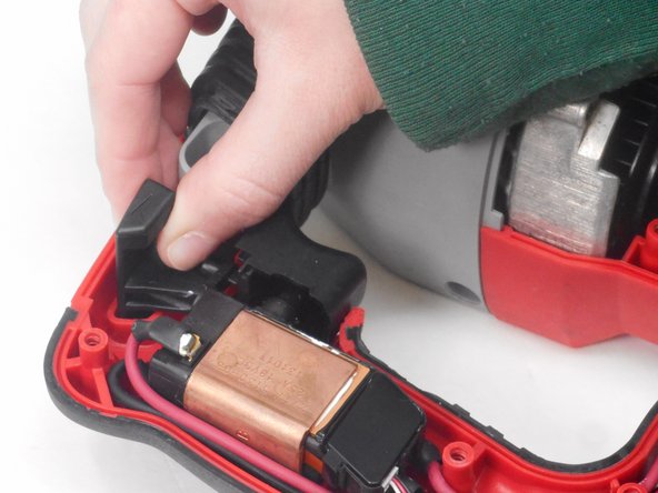

  8. Milwaukee Rotary Hammer 260520 D14A 2016 Forward/Reverse Shuttle Replacement, Forward/Reverse Shuttle: crwdns2935265:08crwdnd2935265:01crwdnd2935265:02crwdne2935265:0 Milwaukee Rotary Hammer 260520 D14A 2016 Forward/Reverse Shuttle Replacement, Forward/Reverse Shuttle: crwdns2935265:08crwdnd2935265:02crwdnd2935265:02crwdne2935265:0
    • Locate the forward/reverse shuttle on the drill, just behind the drill trigger mechanism.
    • Gently pull the trigger down and remove the damaged fwd/rev shuttle.
    • Add in the replacement part, ensuring that the shuttle locks into place.
