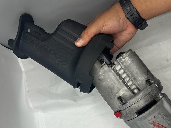

  3. Milwaukee Reciprocating Saw 6538-21-B36B (2010) Shoe Retainer Replacement: crwdns2935265:03crwdnd2935265:01crwdnd2935265:02crwdne2935265:0 Milwaukee Reciprocating Saw 6538-21-B36B (2010) Shoe Retainer Replacement: crwdns2935265:03crwdnd2935265:02crwdnd2935265:02crwdne2935265:0
    • Remove the gearcase insulator by folding over the rubber, dislodging the insulator from the red shift lever, and pulling it off.
    • Using the screwdriver to help lift the rubber over the lever and folding it over may be helpful.

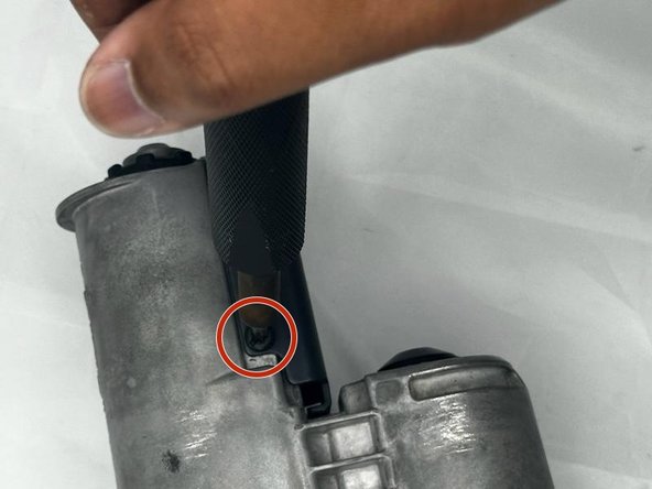

  5. Milwaukee Reciprocating Saw 6538-21-B36B (2010) Shoe Retainer Replacement: crwdns2935265:05crwdnd2935265:01crwdnd2935265:01crwdne2935265:0
    • The shoe pin attaches the retainer to the gearcase and will need to be removed to fully remove the retainer.
    • Use a flathead screwdriver to push the shoe pin from one side of the gearcase to the other.
    • Twist the pin with your finger to remove the pin from the saw.
  6. Milwaukee Reciprocating Saw 6538-21-B36B (2010) Shoe Retainer Replacement: crwdns2935265:06crwdnd2935265:01crwdnd2935265:01crwdne2935265:0
    • Remove the shoe retainer.
