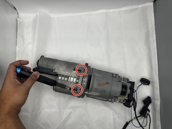

  4. Milwaukee Reciprocating Saw 6538-21-B36B (2010) Service Armature Replacement, Service Armature: crwdns2935265:04crwdnd2935265:01crwdnd2935265:02crwdne2935265:0 Milwaukee Reciprocating Saw 6538-21-B36B (2010) Service Armature Replacement, Service Armature: crwdns2935265:04crwdnd2935265:02crwdnd2935265:02crwdne2935265:0
    • Use a Torx TR20 screwdriver to remove unscrew the four 57.2 mm screws that secure the service field.

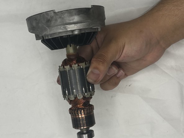

  5. Milwaukee Reciprocating Saw 6538-21-B36B (2010) Service Armature Replacement: crwdns2935265:05crwdnd2935265:01crwdnd2935265:02crwdne2935265:0 Milwaukee Reciprocating Saw 6538-21-B36B (2010) Service Armature Replacement: crwdns2935265:05crwdnd2935265:02crwdnd2935265:02crwdne2935265:0
    • While holding the motor housing, pull out the service armature.
    • Putting your replacement service armature in can be tricky, but remember the spring at the bottom needs to be loaded.
