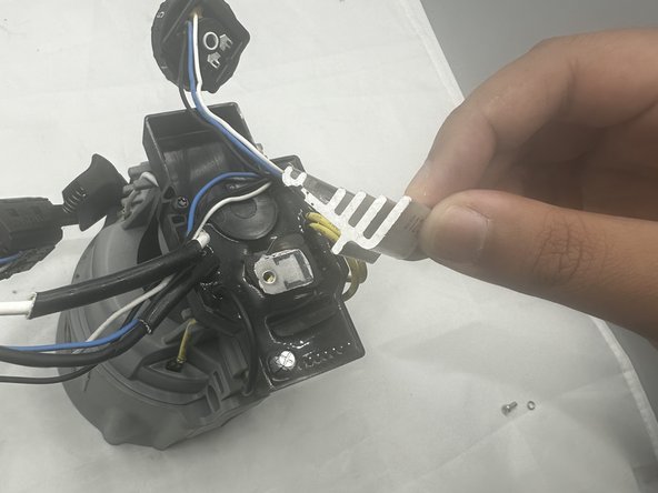

    • Use a T20 Torx screwdriver to remove the five 15.9 mm that fasten the two halves of the handle assembly together.
    • Use a T20 Torx screwdriver to remove the two 25.4 mm screws closest to the motor housing.
  2. Milwaukee Reciprocating Saw 6538-21-B36B (2010) Heat Sink Replacement: crwdns2935265:02crwdnd2935265:01crwdnd2935265:02crwdne2935265:0 Milwaukee Reciprocating Saw 6538-21-B36B (2010) Heat Sink Replacement: crwdns2935265:02crwdnd2935265:02crwdnd2935265:02crwdne2935265:0
    • Remove the right half of the handle assembly.
    • Gently lift out the grey motor housing.
    • Take care not to strain the attached cables.
  3. Milwaukee Reciprocating Saw 6538-21-B36B (2010) Heat Sink Replacement: crwdns2935265:03crwdnd2935265:01crwdnd2935265:02crwdne2935265:0 Milwaukee Reciprocating Saw 6538-21-B36B (2010) Heat Sink Replacement: crwdns2935265:03crwdnd2935265:02crwdnd2935265:02crwdne2935265:0
    • In this picture, the device does not have parts like the service armature, and the gearcase attached. These are not required to be taken off for this guide replacement.
    • Use a T10 Torx screwdrive to remove the single 22.2 mm screw that secures the heat sink.
    • Remove the heatsink.
    • The heat sink is attached with an adhesive and may require a little force to take off.
