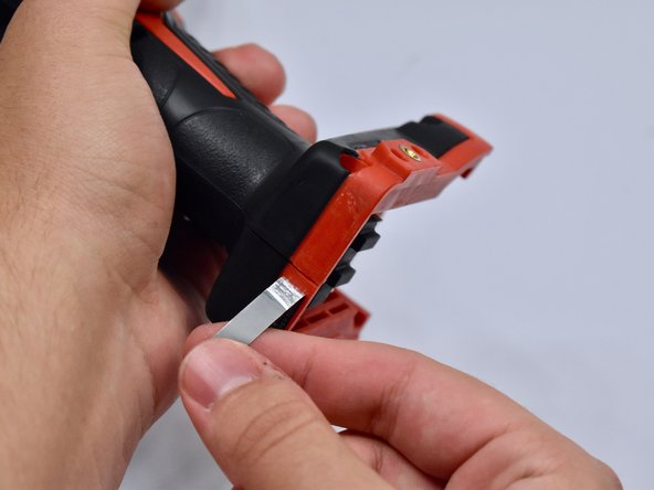

  3. Milwaukee M18 2606-20 Motor Replacement: crwdns2935265:03crwdnd2935265:01crwdnd2935265:02crwdne2935265:0 Milwaukee M18 2606-20 Motor Replacement: crwdns2935265:03crwdnd2935265:02crwdnd2935265:02crwdne2935265:0
    • Peel back the sticker at the bottom of the drill handle.

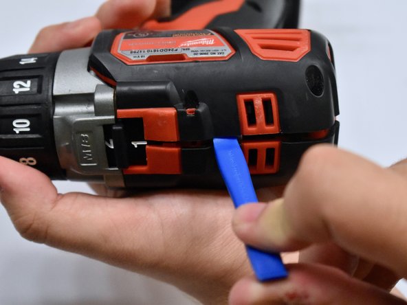

  4. Milwaukee M18 2606-20 Motor Replacement: crwdns2935265:04crwdnd2935265:01crwdnd2935265:02crwdne2935265:0 Milwaukee M18 2606-20 Motor Replacement: crwdns2935265:04crwdnd2935265:02crwdnd2935265:02crwdne2935265:0
    • Open the case by sliding the opening tool all the way around the case to pry it apart.
