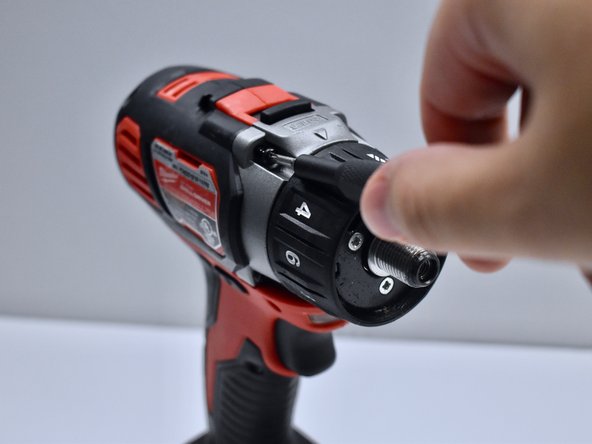

    • Rotate the chuck counterclockwise to open the chuck jaws as far as possible.
  2. Milwaukee M18 2606-20 Gearbox Replacement: crwdns2935265:02crwdnd2935265:01crwdnd2935265:02crwdne2935265:0 Milwaukee M18 2606-20 Gearbox Replacement: crwdns2935265:02crwdnd2935265:02crwdnd2935265:02crwdne2935265:0
    • Remove the 28 mm inner screw holding the chuck onto the drill using a Phillips #3 screwdriver.
    • Rotate the screw clockwise to loosen it.
    • The inner chuck screw is reverse threaded which is why it needs to be rotated clockwise.
  3. Milwaukee M18 2606-20 Gearbox Replacement: crwdns2935265:03crwdnd2935265:01crwdnd2935265:02crwdne2935265:0 Milwaukee M18 2606-20 Gearbox Replacement: crwdns2935265:03crwdnd2935265:02crwdnd2935265:02crwdne2935265:0
    • Insert an Allen wrench into the chuck and tighten the chuck onto the wrench.
    • The Allen wrench will be used for leverage when removing the chuck.
    • When the chuck is tightened it could make a clicking sound. This is fine and is not causing any harm to the drill.

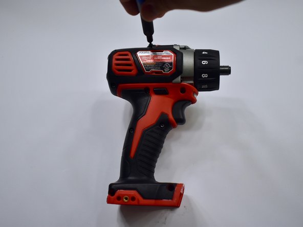

    • Using the T3 Torx screwdriver, remove the seven 18 mm screws from the handle area of the case.
    • Using the T3 Torx screwdriver, remove the two 21 mm screws from the top of the case.

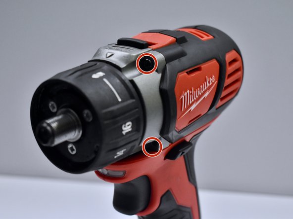

  6. Milwaukee M18 2606-20 Gearbox Replacement: crwdns2935265:06crwdnd2935265:01crwdnd2935265:03crwdne2935265:0 Milwaukee M18 2606-20 Gearbox Replacement: crwdns2935265:06crwdnd2935265:02crwdnd2935265:03crwdne2935265:0 Milwaukee M18 2606-20 Gearbox Replacement: crwdns2935265:06crwdnd2935265:03crwdnd2935265:03crwdne2935265:0
    • Using the T3 Torx screwdriver, remove the four 20 mm screws from the front of the case.

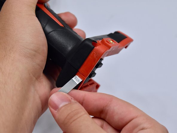

  7. Milwaukee M18 2606-20 Gearbox Replacement: crwdns2935265:07crwdnd2935265:01crwdnd2935265:02crwdne2935265:0 Milwaukee M18 2606-20 Gearbox Replacement: crwdns2935265:07crwdnd2935265:02crwdnd2935265:02crwdne2935265:0
    • Peel back the sticker at the bottom of the drill handle.

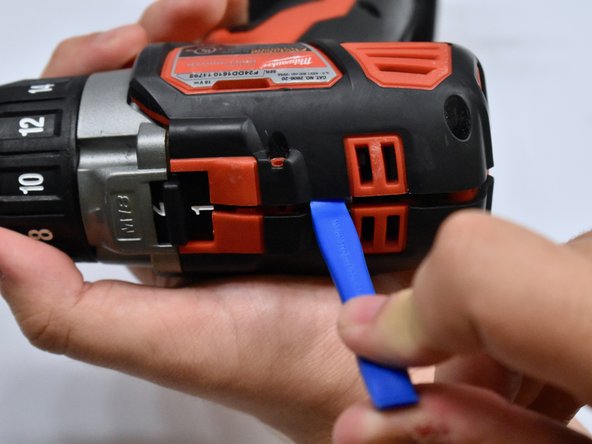

    • Open the case by sliding the opening tool all the way around the case to pry it apart.
