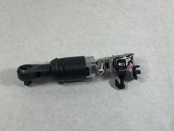

  4. Milwaukee M12 2457-20 Disassembly: crwdns2935265:04crwdnd2935265:01crwdnd2935265:02crwdne2935265:0 Milwaukee M12 2457-20 Disassembly: crwdns2935265:04crwdnd2935265:02crwdnd2935265:02crwdne2935265:0
    • Separate the two housing parts of the tool.
    • Remove the 3/8" yoke assembly and the motor assembly from the tool housing.

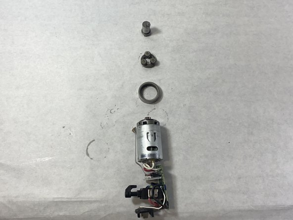

  5. Milwaukee M12 2457-20 Disassembly: crwdns2935265:05crwdnd2935265:01crwdnd2935265:02crwdne2935265:0 Milwaukee M12 2457-20 Disassembly: crwdns2935265:05crwdnd2935265:02crwdnd2935265:02crwdne2935265:0
    • Remove the drive pin connecting the 3/8" yoke assembly and the motor assembly.
    • Remove the crankshaft, planet gears, carrier assembly, and ring gear from the motor assembly.
    • Be aware that these parts are lubricated with grease.
  6. Milwaukee M12 2457-20 Disassembly: crwdns2935265:06crwdnd2935265:01crwdnd2935265:01crwdne2935265:0
    • You have now successfully dismantled the device.
