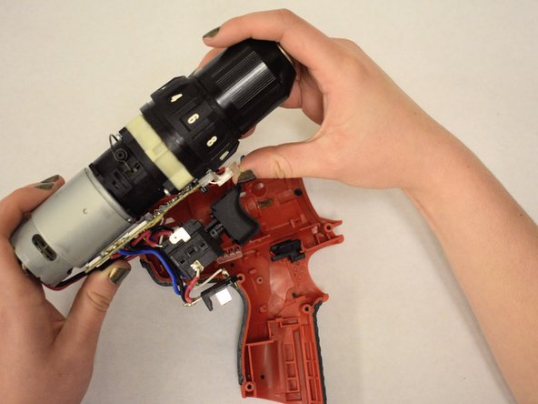

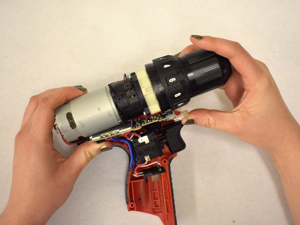

  3. Milwaukee M12 2407-20 Speed Selector Lever Replacement, Speed Selector Lever: crwdns2935265:03crwdnd2935265:01crwdnd2935265:03crwdne2935265:0 Milwaukee M12 2407-20 Speed Selector Lever Replacement, Speed Selector Lever: crwdns2935265:03crwdnd2935265:02crwdnd2935265:03crwdne2935265:0 Milwaukee M12 2407-20 Speed Selector Lever Replacement, Speed Selector Lever: crwdns2935265:03crwdnd2935265:03crwdnd2935265:03crwdne2935265:0
    • Remove the unit from the housing assembly and set the housing assembly aside.
  4. Milwaukee M12 2407-20 Speed Selector Lever Replacement: crwdns2935265:04crwdnd2935265:01crwdnd2935265:01crwdne2935265:0
    • Use a spudger to pry the broken speed selector lever off the assembly.
