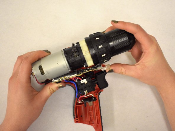

      • Remove each of the seven 14mm Pan Hd. T-10 ST screws on one side of the housing assembly using the T10 screwdriver.
    2. Milwaukee M12 2407-20 Shuttle Spring Plate Replacement: crwdns2935265:02crwdnd2935265:01crwdnd2935265:01crwdne2935265:0
      • Remove metal clip located at the base of the drill, where the battery is to be inserted.
      • You may need to use a spudger if the clip is too difficult to remove with your fingers.
    1. Milwaukee M12 2407-20 Shuttle Spring Plate Replacement, Shuttle Spring Plate: crwdns2935265:03crwdnd2935265:01crwdnd2935265:03crwdne2935265:0 Milwaukee M12 2407-20 Shuttle Spring Plate Replacement, Shuttle Spring Plate: crwdns2935265:03crwdnd2935265:02crwdnd2935265:03crwdne2935265:0 Milwaukee M12 2407-20 Shuttle Spring Plate Replacement, Shuttle Spring Plate: crwdns2935265:03crwdnd2935265:03crwdnd2935265:03crwdne2935265:0
      • Use both hands to lift and remove the gear case assembly from the shell casing.
      • Set the gear case assembly aside.

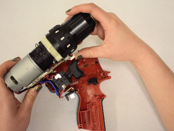

    2. Milwaukee M12 2407-20 Shuttle Spring Plate Replacement: crwdns2935265:04crwdnd2935265:01crwdnd2935265:02crwdne2935265:0 Milwaukee M12 2407-20 Shuttle Spring Plate Replacement: crwdns2935265:04crwdnd2935265:02crwdnd2935265:02crwdne2935265:0
      • Remove the forward/reversing shuttle to gain access to the spring plate.

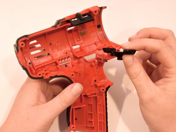

    3. Milwaukee M12 2407-20 Shuttle Spring Plate Replacement: crwdns2935265:05crwdnd2935265:01crwdnd2935265:01crwdne2935265:0
      • Remove the spring plate and insert replacement spring plate.
