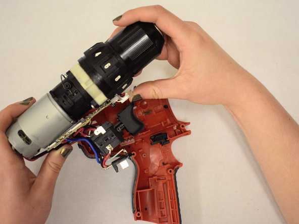

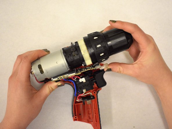

    • Use both hands to remove the gear case assembly from the casing.
    • Set the assembly aside.

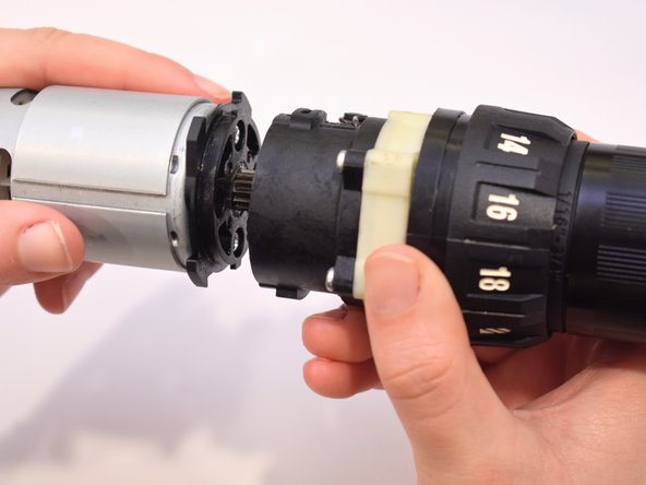

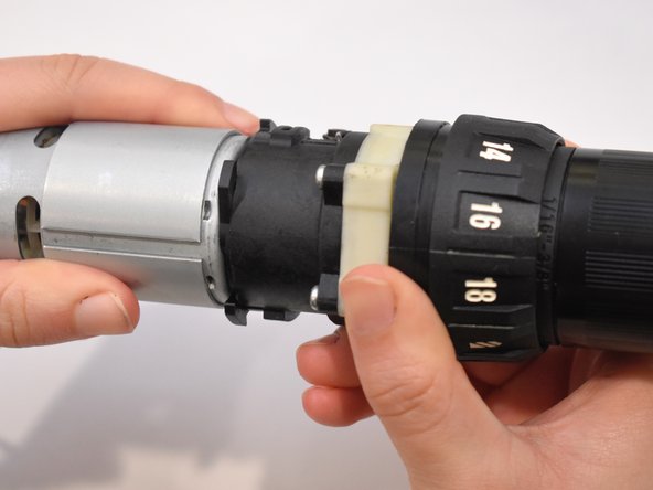

    • Orient the assembly so that it is horizontal.
    • Using your left hand, twist the motor assembly to the left.
    • Pull the motor assembly from the gear case assembly. Set the motor assembly aside.

The instruction in step 4 to have the assembly horizontal is absolutely wrong and TERRIBLE advice. The gears all fell out the back. Luckily I am replacing the entire gear box and clutch assembly. Otherwise I would have had to completely clean and repack the grease on all of the individual parts after I was lucky enough to find all the gears that rolled into other rooms leaving trails of bearing grease. What s crap tutorial.
