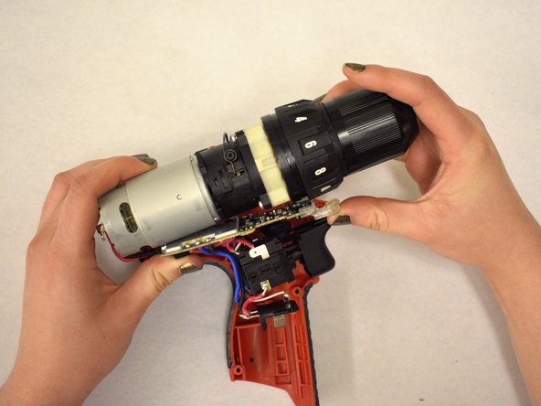

    1. Milwaukee M12 2407-20 Forward/Reverse Shuttle Replacement, Forward/Reverse Shuttle: crwdns2935265:03crwdnd2935265:01crwdnd2935265:03crwdne2935265:0 Milwaukee M12 2407-20 Forward/Reverse Shuttle Replacement, Forward/Reverse Shuttle: crwdns2935265:03crwdnd2935265:02crwdnd2935265:03crwdne2935265:0 Milwaukee M12 2407-20 Forward/Reverse Shuttle Replacement, Forward/Reverse Shuttle: crwdns2935265:03crwdnd2935265:03crwdnd2935265:03crwdne2935265:0
      • Use both hands to lift and remove the gear case assembly from the shell casing.
      • Set the gear case assembly aside.

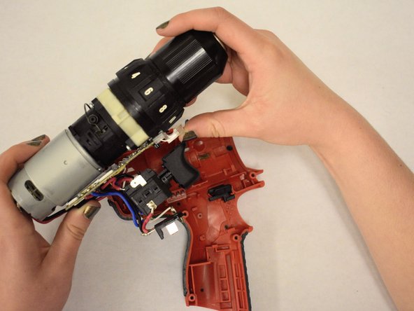

    2. Milwaukee M12 2407-20 Forward/Reverse Shuttle Replacement: crwdns2935265:04crwdnd2935265:01crwdnd2935265:01crwdne2935265:0
      • While holding the shell in one hand, pull the end of the broken forward/reverse shuttle out of the casing.
      • Set the broken forward/reverse shuttle aside.
