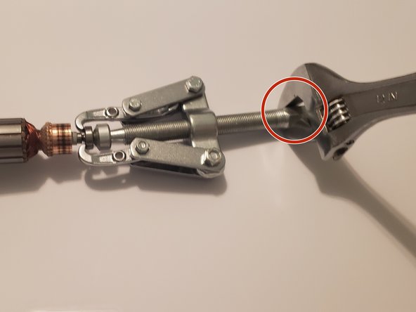

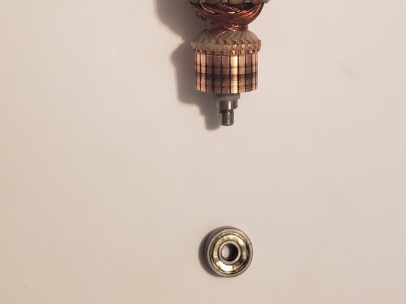

  4. Milwaukee Impact Wrench 9070-20 Rear Motor Bearing Replacement: crwdns2935265:04crwdnd2935265:01crwdnd2935265:03crwdne2935265:0 Milwaukee Impact Wrench 9070-20 Rear Motor Bearing Replacement: crwdns2935265:04crwdnd2935265:02crwdnd2935265:03crwdne2935265:0 Milwaukee Impact Wrench 9070-20 Rear Motor Bearing Replacement: crwdns2935265:04crwdnd2935265:03crwdnd2935265:03crwdne2935265:0
    • Attach a bearing removal tool to the bearing.
    • Tighten the bearing puller until the bearing comes off of the motor shaft.
    • For easier removal, lightly heat the bearing with a propane torch.
    • Heat and then press the replacement bearing onto the shaft.
