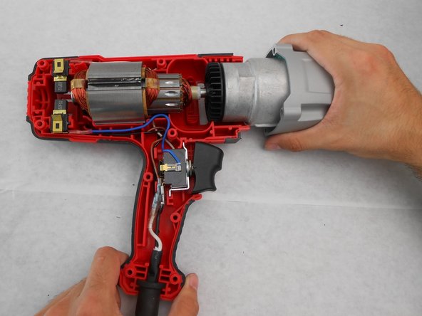

  3. Milwaukee Impact Wrench 9070-20 Motor Brushes Replacement: crwdns2935265:03crwdnd2935265:01crwdnd2935265:03crwdne2935265:0 Milwaukee Impact Wrench 9070-20 Motor Brushes Replacement: crwdns2935265:03crwdnd2935265:02crwdnd2935265:03crwdne2935265:0 Milwaukee Impact Wrench 9070-20 Motor Brushes Replacement: crwdns2935265:03crwdnd2935265:03crwdnd2935265:03crwdne2935265:0
    • Gently remove the upper clam shell.
    • Slide the motor and gearbox assembly out the front of the device and set it aside.
    • Abrupt pulling may damage the motor brushes. Please remove it with caution.
    • The brushes may need to be compressed in order for the motor to be removed.

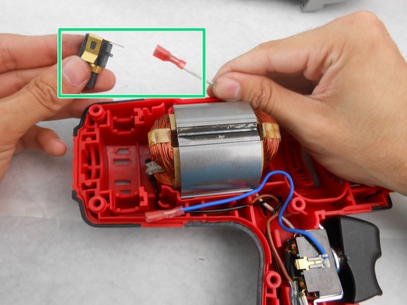

  4. Milwaukee Impact Wrench 9070-20 Motor Brushes Replacement: crwdns2935265:04crwdnd2935265:01crwdnd2935265:02crwdne2935265:0 Milwaukee Impact Wrench 9070-20 Motor Brushes Replacement: crwdns2935265:04crwdnd2935265:02crwdnd2935265:02crwdne2935265:0
    • Remove the brushes from the mount by pulling the brush body directly upward.
    • Disconnect the blue wire from the lower brush.
    • Disconnect the white wire from the upper brush.
    • Reconnect the wires to the new brush and replace them back into the mount.
    • The brushes may need to be compressed in order to slide the motor back into position.
