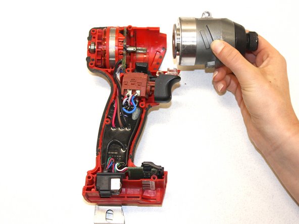

  3. Milwaukee Hex Impact Driver 2753-20 Gear Case Replacement, Gear Case: crwdns2935265:03crwdnd2935265:01crwdnd2935265:01crwdne2935265:0
    • Set the cover aside so the drill body is visible and can be accessed.
    • The gear case is the silver cylinder part with a black tip in the top of the drill.
  4. Milwaukee Hex Impact Driver 2753-20 Gear Case Replacement: crwdns2935265:04crwdnd2935265:01crwdnd2935265:02crwdne2935265:0 Milwaukee Hex Impact Driver 2753-20 Gear Case Replacement: crwdns2935265:04crwdnd2935265:02crwdnd2935265:02crwdne2935265:0
    • Grip the gear case in one hand while holding the body of the drill with the other.
    • Pull outward to remove.
    • Remove carefully, being mindful of the connecting wires. Damage to these wires can cause permanent damage to the drill.
  5. Milwaukee Hex Impact Driver 2753-20 Gear Case Replacement: crwdns2935265:05crwdnd2935265:01crwdnd2935265:01crwdne2935265:0
    • Check the connection from the motor to the trigger.
    • Check that the connection to the circuit board is intact.
    • If both connections are intact, the gears inside the gear case assembly may be jammed and need to be replaced.
