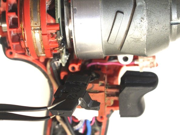

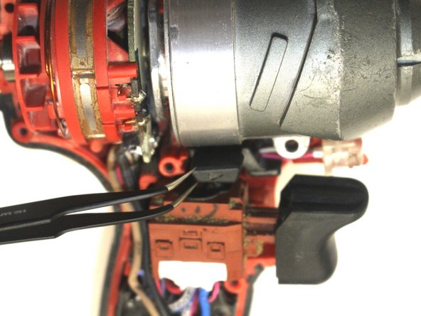

  3. Milwaukee Hex Impact Driver 2750-20 Directional Switch Replacement, Directional Switch: crwdns2935265:03crwdnd2935265:01crwdnd2935265:03crwdne2935265:0 Milwaukee Hex Impact Driver 2750-20 Directional Switch Replacement, Directional Switch: crwdns2935265:03crwdnd2935265:02crwdnd2935265:03crwdne2935265:0 Milwaukee Hex Impact Driver 2750-20 Directional Switch Replacement, Directional Switch: crwdns2935265:03crwdnd2935265:03crwdnd2935265:03crwdne2935265:0
    • Remove the trigger assembly completely.
    • Remove the directional switch by lifting upward using a pair of tweezers, clearing the alignment pole on the trigger assembly.
    • Insert a new directional switch by aligning the hole on the switch with the pole on the trigger.
