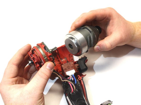

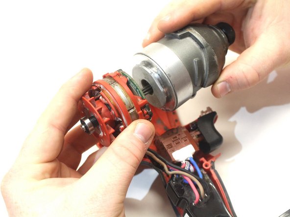

  3. Milwaukee Hex Impact Driver 2750-20 Chuck Drive Shaft Replacement, Chuck Drive Shaft: crwdns2935265:03crwdnd2935265:01crwdnd2935265:03crwdne2935265:0 Milwaukee Hex Impact Driver 2750-20 Chuck Drive Shaft Replacement, Chuck Drive Shaft: crwdns2935265:03crwdnd2935265:02crwdnd2935265:03crwdne2935265:0 Milwaukee Hex Impact Driver 2750-20 Chuck Drive Shaft Replacement, Chuck Drive Shaft: crwdns2935265:03crwdnd2935265:03crwdnd2935265:03crwdne2935265:0
    • Pulling directly outward, remove the driver head from the motor assembly by picking it up out of the casing.
  4. Milwaukee Hex Impact Driver 2750-20 Chuck Drive Shaft Replacement: crwdns2935265:04crwdnd2935265:01crwdnd2935265:01crwdne2935265:0
    • Remove the drive shaft assembly from the motor coils.
    • There will be resistance when removing the drive shaft as there is magnetism working against you.
