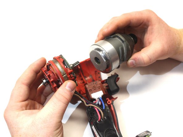

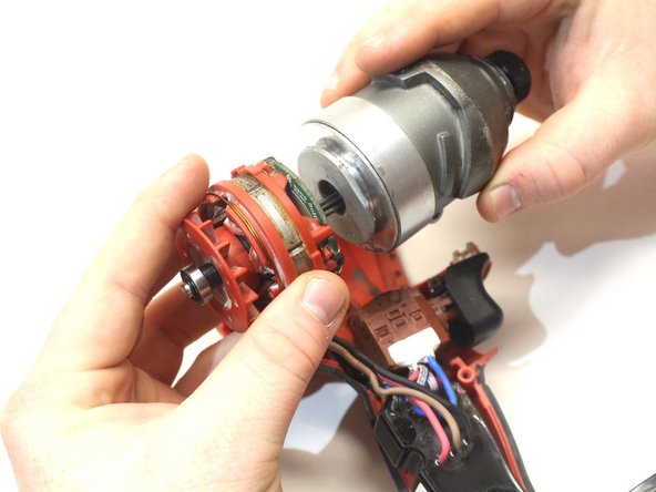

  4. Milwaukee Hex Impact Driver 2750-20  Output Shaft Bearing Replacement: crwdns2935265:04crwdnd2935265:01crwdnd2935265:03crwdne2935265:0 Milwaukee Hex Impact Driver 2750-20  Output Shaft Bearing Replacement: crwdns2935265:04crwdnd2935265:02crwdnd2935265:03crwdne2935265:0 Milwaukee Hex Impact Driver 2750-20  Output Shaft Bearing Replacement: crwdns2935265:04crwdnd2935265:03crwdnd2935265:03crwdne2935265:0
    • Lift the driver head and motor assembly directly out of the outer casing.
    • Pull the driver head away from the motor assembly, separating the two.

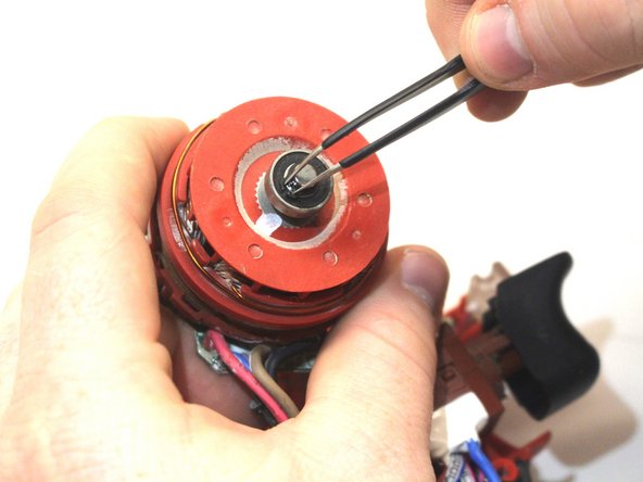

  5. Milwaukee Hex Impact Driver 2750-20  Output Shaft Bearing Replacement: crwdns2935265:05crwdnd2935265:01crwdnd2935265:03crwdne2935265:0 Milwaukee Hex Impact Driver 2750-20  Output Shaft Bearing Replacement: crwdns2935265:05crwdnd2935265:02crwdnd2935265:03crwdne2935265:0 Milwaukee Hex Impact Driver 2750-20  Output Shaft Bearing Replacement: crwdns2935265:05crwdnd2935265:03crwdnd2935265:03crwdne2935265:0
    • Remove the fan and the drive shaft assembly from the motor core assembly.
    • Using a pair of tweezers, remove the retaining ring.
    • Remove the old bearing and reinstall the new retaining clip.
