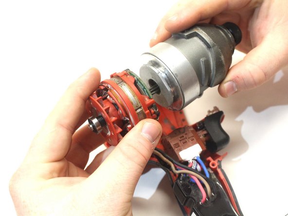

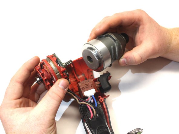

  3. Milwaukee Hex Impact Driver 2750-20  Driver Head Replacement, Driver Head: crwdns2935265:03crwdnd2935265:01crwdnd2935265:03crwdne2935265:0 Milwaukee Hex Impact Driver 2750-20  Driver Head Replacement, Driver Head: crwdns2935265:03crwdnd2935265:02crwdnd2935265:03crwdne2935265:0 Milwaukee Hex Impact Driver 2750-20  Driver Head Replacement, Driver Head: crwdns2935265:03crwdnd2935265:03crwdnd2935265:03crwdne2935265:0
    • Lift the driver head and motor assembly directly out of the outer casing.
    • Pull the driver head away from the motor assembly, separating the two.
