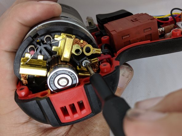

  3. Milwaukee Hex Impact Driver 2656-20 Trigger Assembly  Replacement, Trigger Assembly: crwdns2935265:03crwdnd2935265:01crwdnd2935265:02crwdne2935265:0 Milwaukee Hex Impact Driver 2656-20 Trigger Assembly  Replacement, Trigger Assembly: crwdns2935265:03crwdnd2935265:02crwdnd2935265:02crwdne2935265:0
    • Remove the two 6 mm screws on the back of the brush card assembly using the T10 Torx screwdriver.
    • Move the two wires out of the way.
