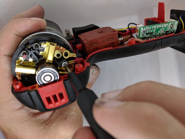

  6. Milwaukee Hex Impact Driver 2656-20 Electric Motor Replacement: crwdns2935265:06crwdnd2935265:01crwdnd2935265:02crwdne2935265:0 Milwaukee Hex Impact Driver 2656-20 Electric Motor Replacement: crwdns2935265:06crwdnd2935265:02crwdnd2935265:02crwdne2935265:0
    • Insert the opening pick between one of the carbon brushes and the electric motor to help compress the spring.
    • While compressing the spring slide that section of the brush block assembly over the bearing.
    • The brush block assembly should easily slide over the bearing now , if it does not repeat the above process as needed for the other three carbon brushes.
    • When you remove the brush block assembly, the remaining component is the electric motor.
