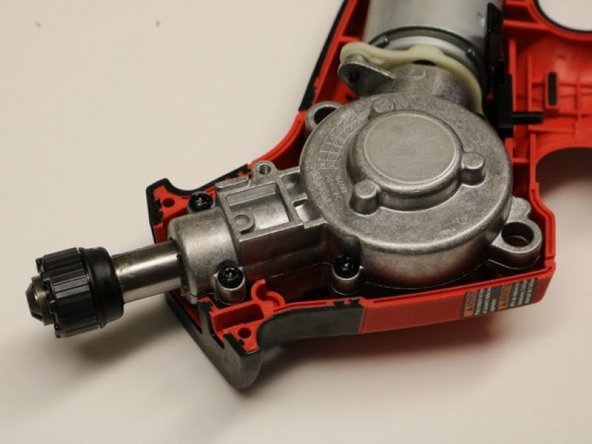

  2. Milwaukee Hackzall 2625-20 Gearbox Replacement, Gearbox: crwdns2935265:02crwdnd2935265:01crwdnd2935265:01crwdne2935265:0
    • Open up the device.

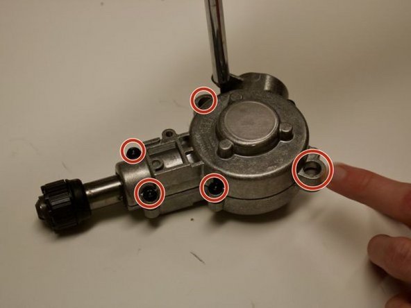

    • Remove the screws that are connecting the shoe to the gearbox using the T15 Torx screwdriver to remove 14.0 mm screws.
    • Pull out the shoe and gearbox to remove the screw on the other side

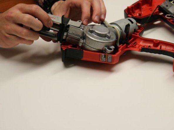

  3. Milwaukee Hackzall 2625-20 Gearbox Replacement: crwdns2935265:03crwdnd2935265:01crwdnd2935265:03crwdne2935265:0 Milwaukee Hackzall 2625-20 Gearbox Replacement: crwdns2935265:03crwdnd2935265:02crwdnd2935265:03crwdne2935265:0 Milwaukee Hackzall 2625-20 Gearbox Replacement: crwdns2935265:03crwdnd2935265:03crwdnd2935265:03crwdne2935265:0
    • Using your finger, push the rubber band up then slide the shoe off of the blade clamping mechanism.

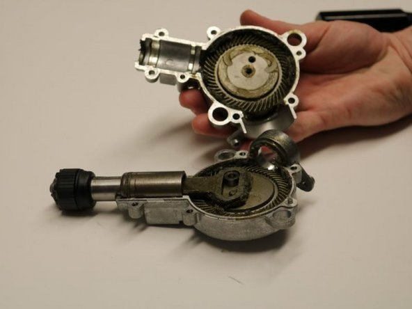

  4. Milwaukee Hackzall 2625-20 Gearbox Replacement: crwdns2935265:04crwdnd2935265:01crwdnd2935265:03crwdne2935265:0 Milwaukee Hackzall 2625-20 Gearbox Replacement: crwdns2935265:04crwdnd2935265:02crwdnd2935265:03crwdne2935265:0 Milwaukee Hackzall 2625-20 Gearbox Replacement: crwdns2935265:04crwdnd2935265:03crwdnd2935265:03crwdne2935265:0
    • Detach the gearbox from the motor.
    • Remove the screws from the gearbox to expose the blade camping mechanism, then pull out the blade clamping mechanism from the gearbox. You will use a T15 Torx screwdriver to remove 14.0 mm screws.
