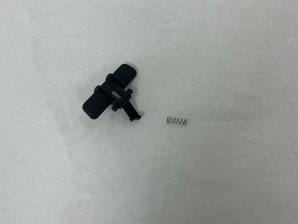

  3. Milwaukee Circular Saw 263020 B57A 2008 Switch Replacement, Switch: crwdns2935265:03crwdnd2935265:01crwdnd2935265:02crwdne2935265:0 Milwaukee Circular Saw 263020 B57A 2008 Switch Replacement, Switch: crwdns2935265:03crwdnd2935265:02crwdnd2935265:02crwdne2935265:0
    • Take the start switch out of the device gently without moving any other hardware.

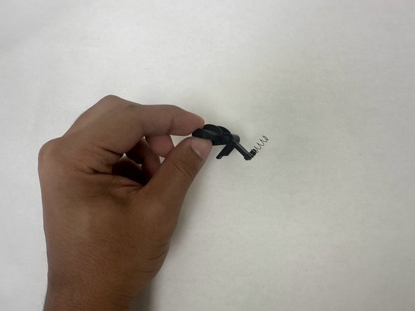

  4. Milwaukee Circular Saw 263020 B57A 2008 Switch Replacement: crwdns2935265:04crwdnd2935265:01crwdnd2935265:02crwdne2935265:0 Milwaukee Circular Saw 263020 B57A 2008 Switch Replacement: crwdns2935265:04crwdnd2935265:02crwdnd2935265:02crwdne2935265:0
    • Carefully pull the spring underneath the switch away from the switch.
