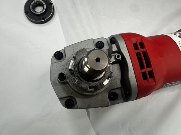

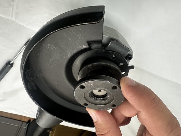

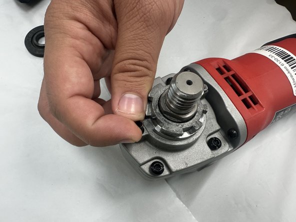

    • Position the cut-off wheel so that is facing upward.
    • Remove the top flange nut by turning it counterclockwise.
    • If a disc replacement is necessary, you will find the disc located beneath the top flange nut.
    • Pull the flange upward from the spindle to remove it.

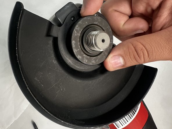

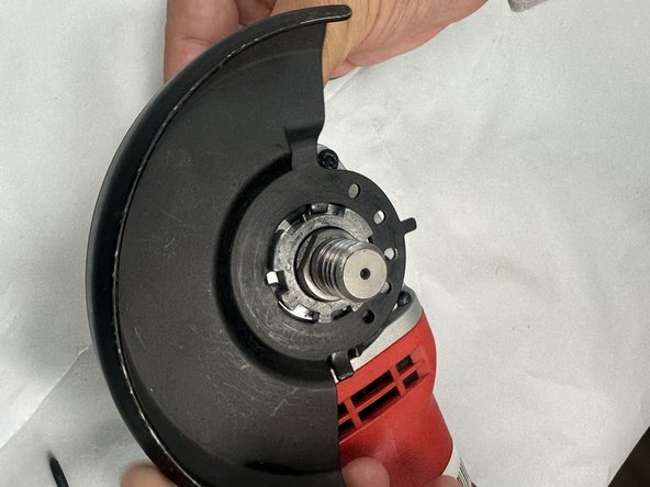

  2. Milwaukee 6130-33 Gear Replacement: crwdns2935265:02crwdnd2935265:01crwdnd2935265:02crwdne2935265:0 Milwaukee 6130-33 Gear Replacement: crwdns2935265:02crwdnd2935265:02crwdnd2935265:02crwdne2935265:0
    • Press down on the detent tab to release the guard lock.
    • Remove guard from detent tab.
    • Gently wiggle when remove from left to right before pulling up.

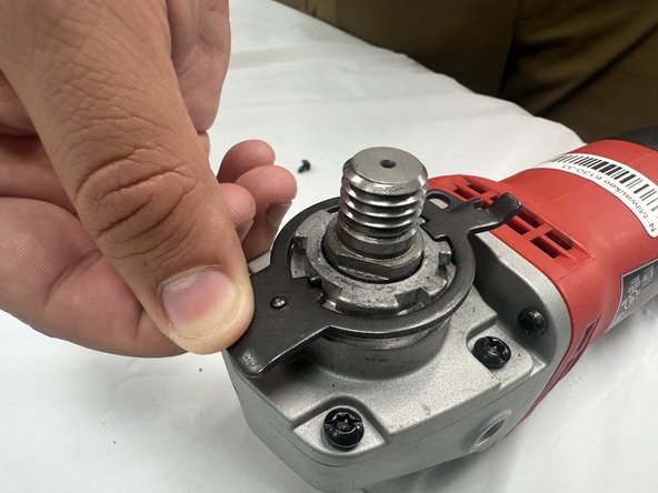

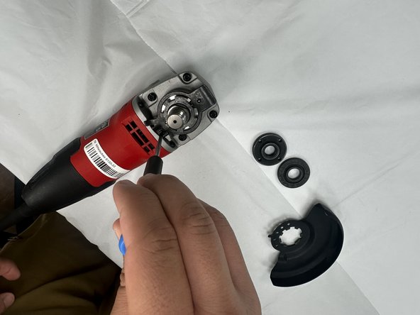

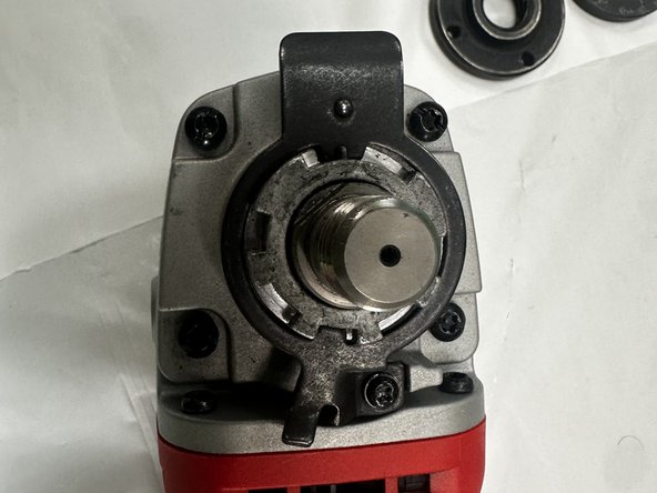

  3. Milwaukee 6130-33 Gear Replacement: crwdns2935265:03crwdnd2935265:01crwdnd2935265:03crwdne2935265:0 Milwaukee 6130-33 Gear Replacement: crwdns2935265:03crwdnd2935265:02crwdnd2935265:03crwdne2935265:0 Milwaukee 6130-33 Gear Replacement: crwdns2935265:03crwdnd2935265:03crwdnd2935265:03crwdne2935265:0
    • Remove the 3 mm Phillips #1 screw that secures the detent tab.
  4. Milwaukee 6130-33 Gear Replacement: crwdns2935265:04crwdnd2935265:01crwdnd2935265:02crwdne2935265:0 Milwaukee 6130-33 Gear Replacement: crwdns2935265:04crwdnd2935265:02crwdnd2935265:02crwdne2935265:0
    • Push down on top of detent tab, then remove detent tab by pulling upwards.
  5. Milwaukee 6130-33 Gear Replacement: crwdns2935265:05crwdnd2935265:01crwdnd2935265:03crwdne2935265:0 Milwaukee 6130-33 Gear Replacement: crwdns2935265:05crwdnd2935265:02crwdnd2935265:03crwdne2935265:0 Milwaukee 6130-33 Gear Replacement: crwdns2935265:05crwdnd2935265:03crwdnd2935265:03crwdne2935265:0
    • Remove the spring between the two top corner screws.

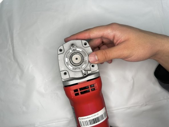

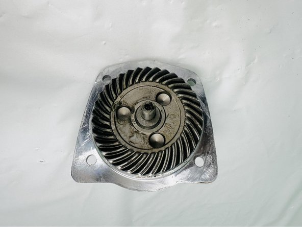

  6. Milwaukee 6130-33 Gear Replacement, Gear: crwdns2935265:06crwdnd2935265:01crwdnd2935265:02crwdne2935265:0 Milwaukee 6130-33 Gear Replacement, Gear: crwdns2935265:06crwdnd2935265:02crwdnd2935265:02crwdne2935265:0
    • Remove the four 6 mm flathead #6 screws from the gear cover.
  7. Milwaukee 6130-33 Gear Replacement: crwdns2935265:07crwdnd2935265:01crwdnd2935265:01crwdne2935265:0
    • Remove the casing using a scraper tool, pull up on each side to remove.
    • Applying excessive force can lead to accidents due to the sharp edges of the casing and tool
  8. Milwaukee 6130-33 Gear Replacement: crwdns2935265:08crwdnd2935265:01crwdnd2935265:02crwdne2935265:0 Milwaukee 6130-33 Gear Replacement: crwdns2935265:08crwdnd2935265:02crwdnd2935265:02crwdne2935265:0
    • Remove the gear from the casing.
    • When removing the gear, the interior can be accessed for cleaning or inspection.
