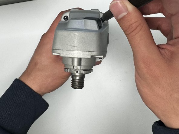

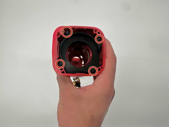

  4. Milwaukee 6130-33 Fan Casing Replacement, Fan Casing: crwdns2935265:04crwdnd2935265:01crwdnd2935265:02crwdne2935265:0 Milwaukee 6130-33 Fan Casing Replacement, Fan Casing: crwdns2935265:04crwdnd2935265:02crwdnd2935265:02crwdne2935265:0
    • Remove the four 4 mm TR20 Torx screws from the gear casing.

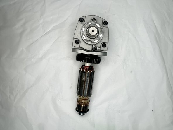

  5. Milwaukee 6130-33 Fan Casing Replacement: crwdns2935265:05crwdnd2935265:01crwdnd2935265:02crwdne2935265:0 Milwaukee 6130-33 Fan Casing Replacement: crwdns2935265:05crwdnd2935265:02crwdnd2935265:02crwdne2935265:0
    • Remove the case head attached to the rotor by pulling it up and off.

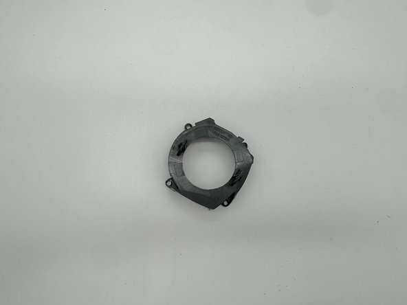

  6. Milwaukee 6130-33 Fan Casing Replacement: crwdns2935265:06crwdnd2935265:01crwdnd2935265:03crwdne2935265:0 Milwaukee 6130-33 Fan Casing Replacement: crwdns2935265:06crwdnd2935265:02crwdnd2935265:03crwdne2935265:0 Milwaukee 6130-33 Fan Casing Replacement: crwdns2935265:06crwdnd2935265:03crwdnd2935265:03crwdne2935265:0
    • Remove the four 3.5 mm TR10 Torx screws from the fan casing.
    • Remove the fan casing to access the inside casing.
