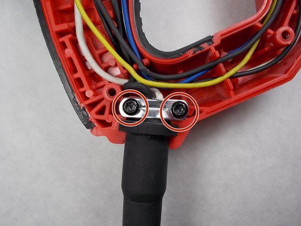

  3. Milwaukee 5262-21 Power Cord Replacement, Power Cord: crwdns2935265:03crwdnd2935265:01crwdnd2935265:02crwdne2935265:0 Milwaukee 5262-21 Power Cord Replacement, Power Cord: crwdns2935265:03crwdnd2935265:02crwdnd2935265:02crwdne2935265:0
    • Remove the two 11.5mm T-15 screws shown in red.

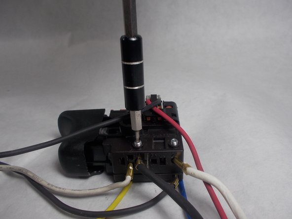

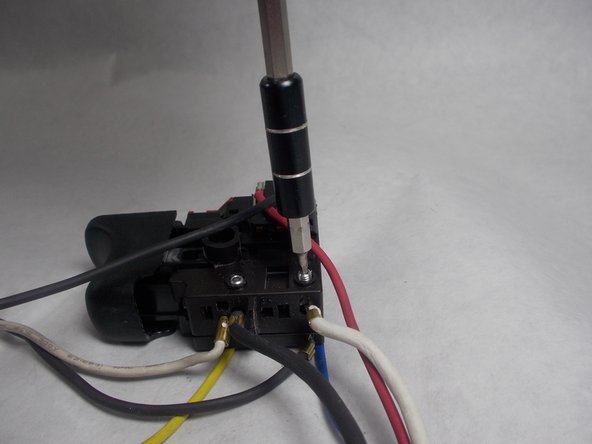

    • Follow the black and white cord to the trigger.
    • On the trigger there are two small bolts that you have to loosen.
    • Loosen them slightly with a H - 1.5 bit.
  5. Milwaukee 5262-21 Power Cord Replacement: crwdns2935265:05crwdnd2935265:01crwdnd2935265:03crwdne2935265:0 Milwaukee 5262-21 Power Cord Replacement: crwdns2935265:05crwdnd2935265:02crwdnd2935265:03crwdne2935265:0 Milwaukee 5262-21 Power Cord Replacement: crwdns2935265:05crwdnd2935265:03crwdnd2935265:03crwdne2935265:0

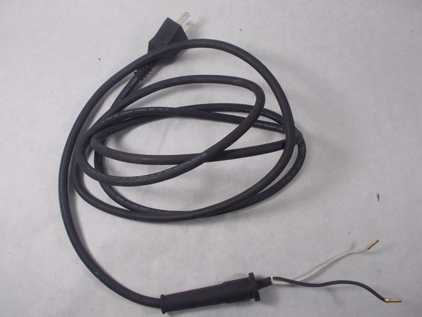

    • Once the bolts are loose you can pull both cords straight out from the trigger.
    • Pull the cable from the chassis and put it to the side and it has been successfully removed.
