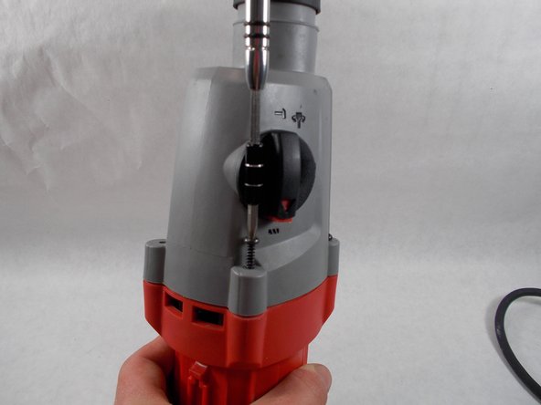

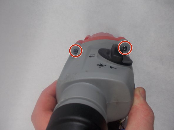

    • Remove the ten 19mm T20 Torx screws shown in red.
  2. Milwaukee 5262-21 Diaphragm Assembly with Bushing Replacement: crwdns2935265:02crwdnd2935265:01crwdnd2935265:01crwdne2935265:0
    • Remove the red Housing Assembly by lifting it up off of the tool.

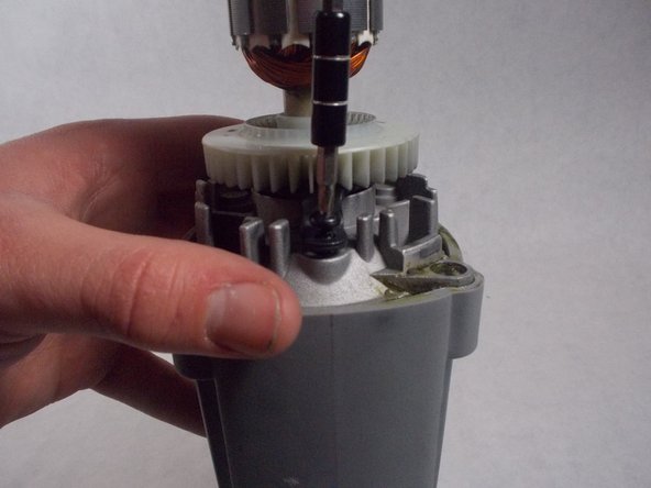

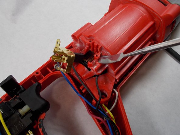

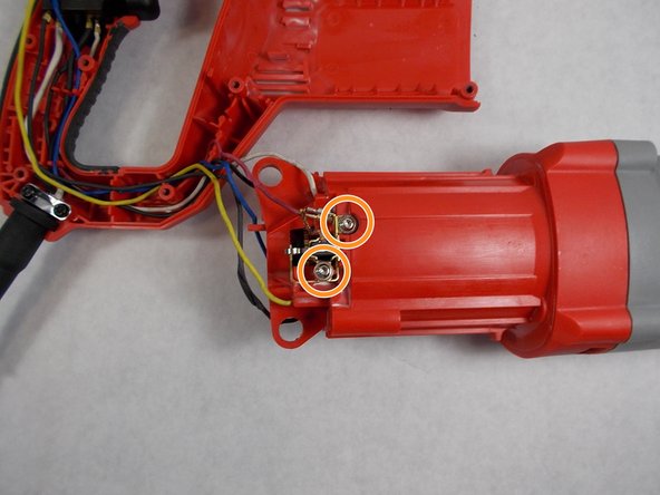

    • Remove the two 10mm T-10 Torx screws that attach the top brush holders to the motor housing.
    • Remove the two 10mm T-10 Torx screws that attach the bottom brush holders to the motor housing.

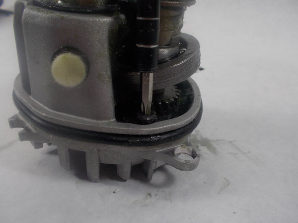

  4. Milwaukee 5262-21 Diaphragm Assembly with Bushing Replacement: crwdns2935265:04crwdnd2935265:01crwdnd2935265:02crwdne2935265:0 Milwaukee 5262-21 Diaphragm Assembly with Bushing Replacement: crwdns2935265:04crwdnd2935265:02crwdnd2935265:02crwdne2935265:0
    • Using a metal spudger, pry off each brush holder.

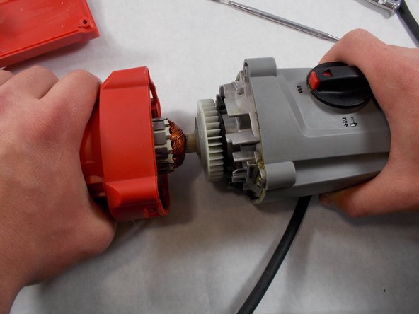

  6. Milwaukee 5262-21 Diaphragm Assembly with Bushing Replacement: crwdns2935265:06crwdnd2935265:01crwdnd2935265:02crwdne2935265:0 Milwaukee 5262-21 Diaphragm Assembly with Bushing Replacement: crwdns2935265:06crwdnd2935265:02crwdnd2935265:02crwdne2935265:0
    • Pull the front portion of the tool out from the motor housing.

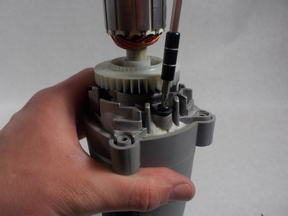

  8. Milwaukee 5262-21 Diaphragm Assembly with Bushing Replacement: crwdns2935265:08crwdnd2935265:01crwdnd2935265:02crwdne2935265:0 Milwaukee 5262-21 Diaphragm Assembly with Bushing Replacement: crwdns2935265:08crwdnd2935265:02crwdnd2935265:02crwdne2935265:0
    • Pull the 120V armature assembly out of the diaphragm assembly.
  9. Milwaukee 5262-21 Diaphragm Assembly with Bushing Replacement: crwdns2935265:09crwdnd2935265:01crwdnd2935265:02crwdne2935265:0 Milwaukee 5262-21 Diaphragm Assembly with Bushing Replacement: crwdns2935265:09crwdnd2935265:02crwdnd2935265:02crwdne2935265:0

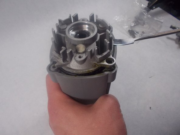

    • Using a metal spudger, pry the diaphgram assembly out of the gear case.

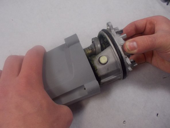

  10. Milwaukee 5262-21 Diaphragm Assembly with Bushing Replacement: crwdns2935265:010crwdnd2935265:01crwdnd2935265:02crwdne2935265:0 Milwaukee 5262-21 Diaphragm Assembly with Bushing Replacement: crwdns2935265:010crwdnd2935265:02crwdnd2935265:02crwdne2935265:0
    • Now that you have loosened the diaphragm, you can now pull it out of the gear case.

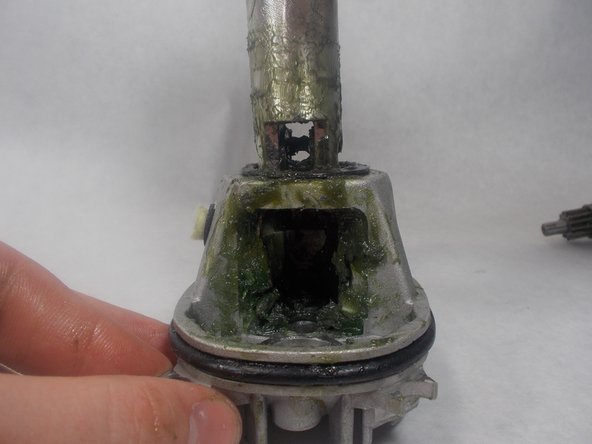

  11. Milwaukee 5262-21 Diaphragm Assembly with Bushing Replacement: crwdns2935265:011crwdnd2935265:01crwdnd2935265:03crwdne2935265:0 Milwaukee 5262-21 Diaphragm Assembly with Bushing Replacement: crwdns2935265:011crwdnd2935265:02crwdnd2935265:03crwdne2935265:0 Milwaukee 5262-21 Diaphragm Assembly with Bushing Replacement: crwdns2935265:011crwdnd2935265:03crwdnd2935265:03crwdne2935265:0

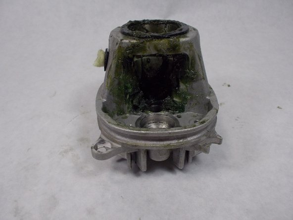

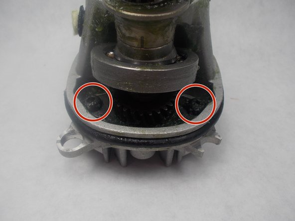

    • The diaphragm assembly will be lathered in grease. In order to move forward, you may want to give it a wipe down to remove any extra grease.
    • After removing some grease (if needed), remove the two 15mm T20 Torx screws shown in red.

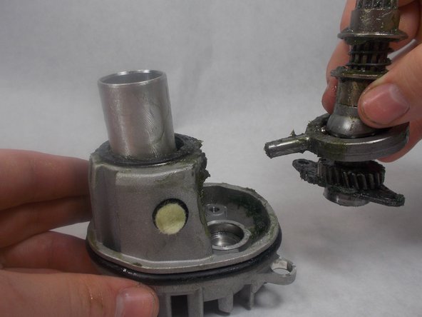

  12. Milwaukee 5262-21 Diaphragm Assembly with Bushing Replacement: crwdns2935265:012crwdnd2935265:01crwdnd2935265:03crwdne2935265:0 Milwaukee 5262-21 Diaphragm Assembly with Bushing Replacement: crwdns2935265:012crwdnd2935265:02crwdnd2935265:03crwdne2935265:0 Milwaukee 5262-21 Diaphragm Assembly with Bushing Replacement: crwdns2935265:012crwdnd2935265:03crwdnd2935265:03crwdne2935265:0

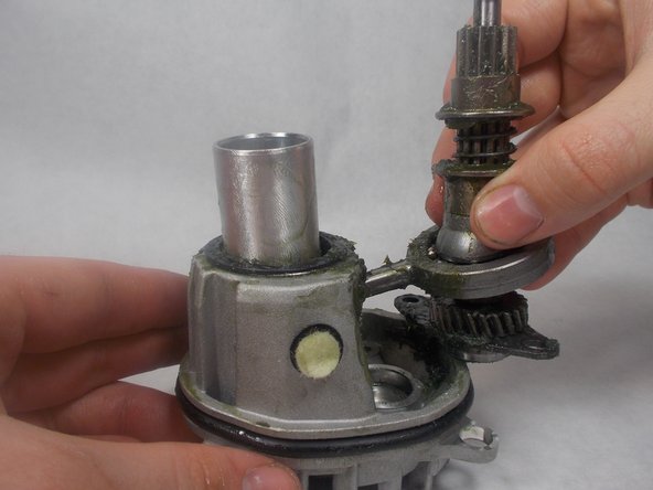

    • Now pull the reduction gear assembly up and out of the diaphragm.
  13. Milwaukee 5262-21 Diaphragm Assembly with Bushing Replacement, Diaphragm Assembly with Bushing: crwdns2935265:013crwdnd2935265:01crwdnd2935265:02crwdne2935265:0 Milwaukee 5262-21 Diaphragm Assembly with Bushing Replacement, Diaphragm Assembly with Bushing: crwdns2935265:013crwdnd2935265:02crwdnd2935265:02crwdne2935265:0
    • Remove the metal piston from the diaphragm assembly.

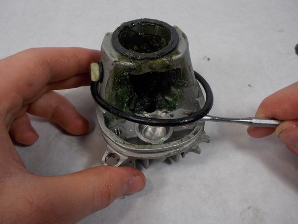

  14. Milwaukee 5262-21 Diaphragm Assembly with Bushing Replacement: crwdns2935265:014crwdnd2935265:01crwdnd2935265:03crwdne2935265:0 Milwaukee 5262-21 Diaphragm Assembly with Bushing Replacement: crwdns2935265:014crwdnd2935265:02crwdnd2935265:03crwdne2935265:0 Milwaukee 5262-21 Diaphragm Assembly with Bushing Replacement: crwdns2935265:014crwdnd2935265:03crwdnd2935265:03crwdne2935265:0
    • Using a metal spudger, pry the o-ring off of the assembly.
