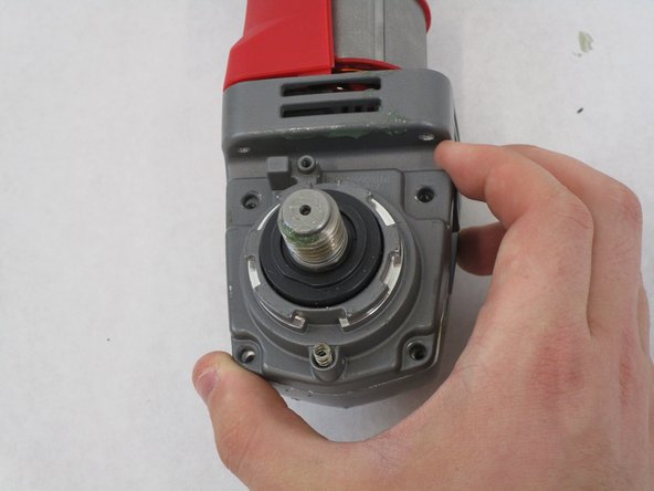

  5. Milwaukee 2780-20 Rotor Assembly Replacement, Rotor Assembly: crwdns2935265:05crwdnd2935265:01crwdnd2935265:03crwdne2935265:0 Milwaukee 2780-20 Rotor Assembly Replacement, Rotor Assembly: crwdns2935265:05crwdnd2935265:02crwdnd2935265:03crwdne2935265:0 Milwaukee 2780-20 Rotor Assembly Replacement, Rotor Assembly: crwdns2935265:05crwdnd2935265:03crwdnd2935265:03crwdne2935265:0
    • Using a Torx T20 screwdriver, unscrew the four 6mm screws located at the top of the gearcase assembly.
    • Pull apart the top of the gearcase assembly to expose the inside of it.

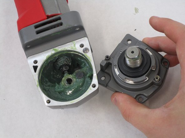

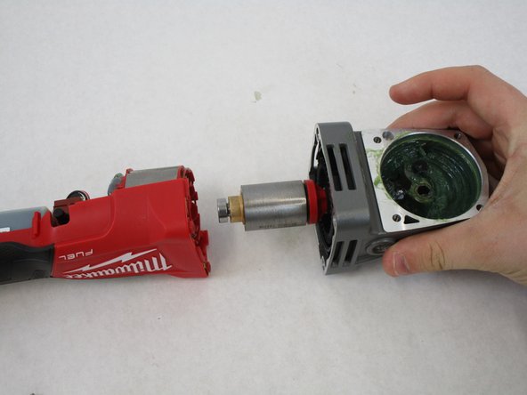

  6. Milwaukee 2780-20 Rotor Assembly Replacement: crwdns2935265:06crwdnd2935265:01crwdnd2935265:02crwdne2935265:0 Milwaukee 2780-20 Rotor Assembly Replacement: crwdns2935265:06crwdnd2935265:02crwdnd2935265:02crwdne2935265:0
    • Pull the Gearcase Assembly away from the electronic kit.

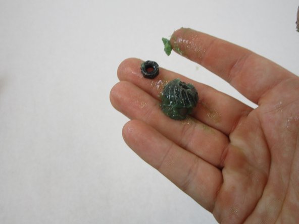

    • Using a 3/8 wrench, remove the nut located in the center of the Gearcase.
    • The nut and pinion will immediately come apart from the Rotor assembly.

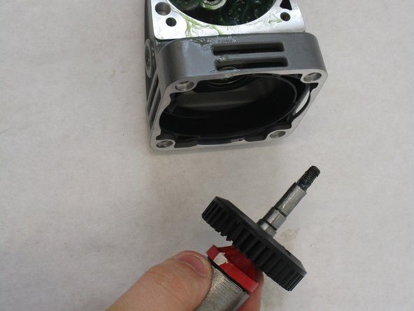

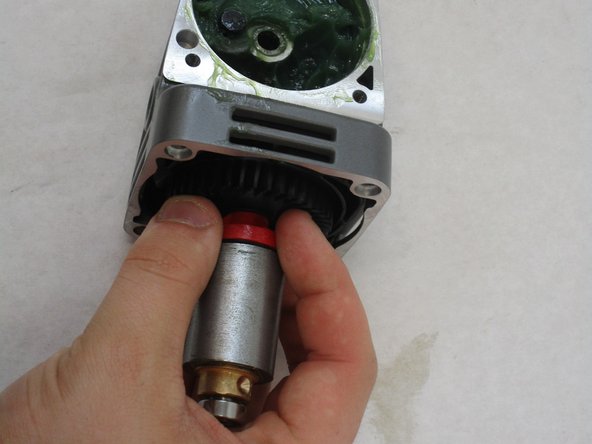

  8. Milwaukee 2780-20 Rotor Assembly Replacement: crwdns2935265:08crwdnd2935265:01crwdnd2935265:03crwdne2935265:0 Milwaukee 2780-20 Rotor Assembly Replacement: crwdns2935265:08crwdnd2935265:02crwdnd2935265:03crwdne2935265:0 Milwaukee 2780-20 Rotor Assembly Replacement: crwdns2935265:08crwdnd2935265:03crwdnd2935265:03crwdne2935265:0
    • Pull the rotor assembly away from the gearcase assembly.
